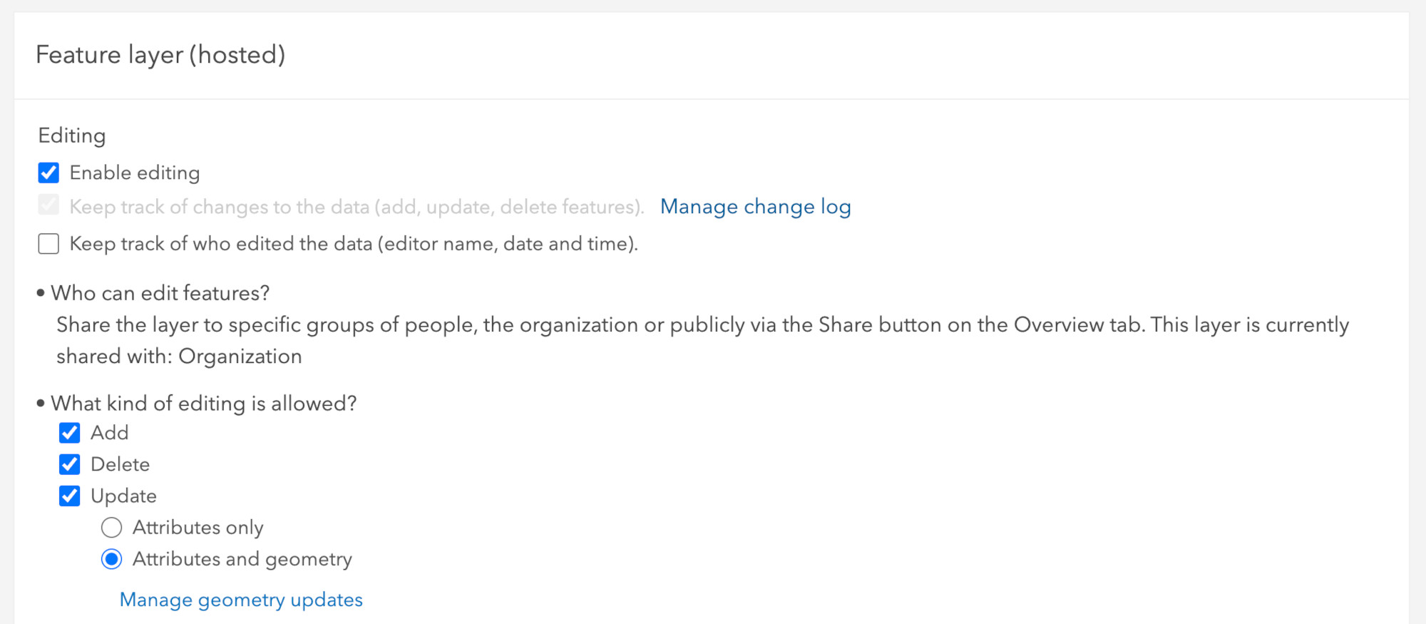

Understanding enabling/disabling layer editing
Editing on the 3D object layer must be enabled once to activate its capabilities. After this initial activation, you can disable editing, restricting edits to only the owner(s).
In ArcGIS Pro, you enable editing by checking the Enable editing option in the first step of “Publishing a 3D object layer.” You can verify this in the ArcGIS Portal after publishing. Open the item page for the associated feature layer, click the Settings tab, and scroll down to the “Feature Layer (hosted)” section. Ensure that the options for Enable editing and Keep track of changes to the data (add, update, delete features) are checked, along with the options for Add, Delete, Update, and Attributes and geometry. If you forgot to enable editing in ArcGIS Pro, check all the above options and click Save to confirm the changes.
To disable editing (after it has been enabled), simply uncheck Enable editing on the same page and click Save. Note that creating an empty 3D object layer in ArcGIS Online automatically activates editing capabilities.
