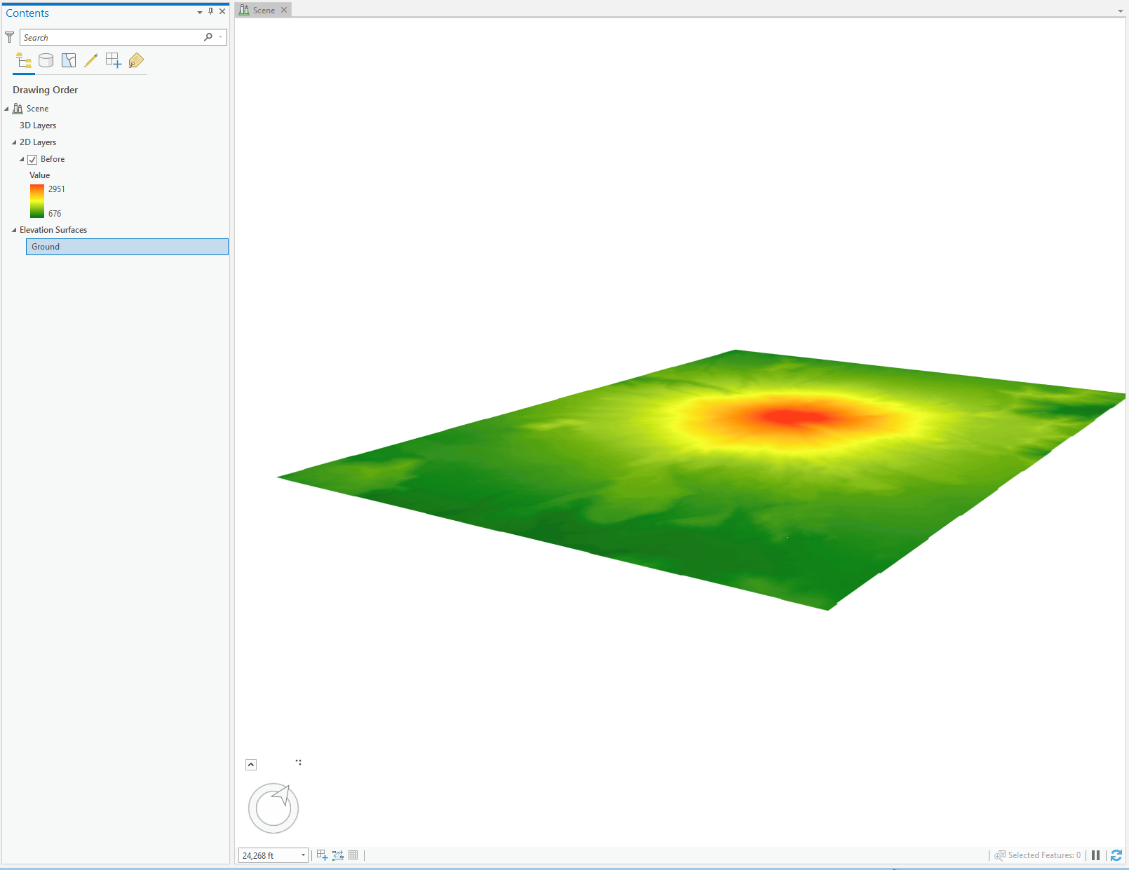

To begin I have an empty scene but you can also start off with the supplied map package provided here. In the scene I removed the Esri provided world elevation and basemap layers. I did this to help keep focus on the layers being published in this blog.
I then added the raster named “Before” to the scene and have the scene clipped to the extent of the data. Having this operational layer added will help give reference to the elevation layer we are publishing. I also adjusted the color ramp used from a grayscale to green-red color ramp.

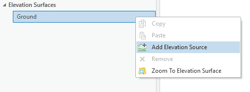

Next add the elevation data to the scene. In this sample it is the same data that is under the 2D Layers section of the Contents pane. Right click on Ground under Elevation Surfaces and click Add Elevation Source to add the the elevation data to the scene.

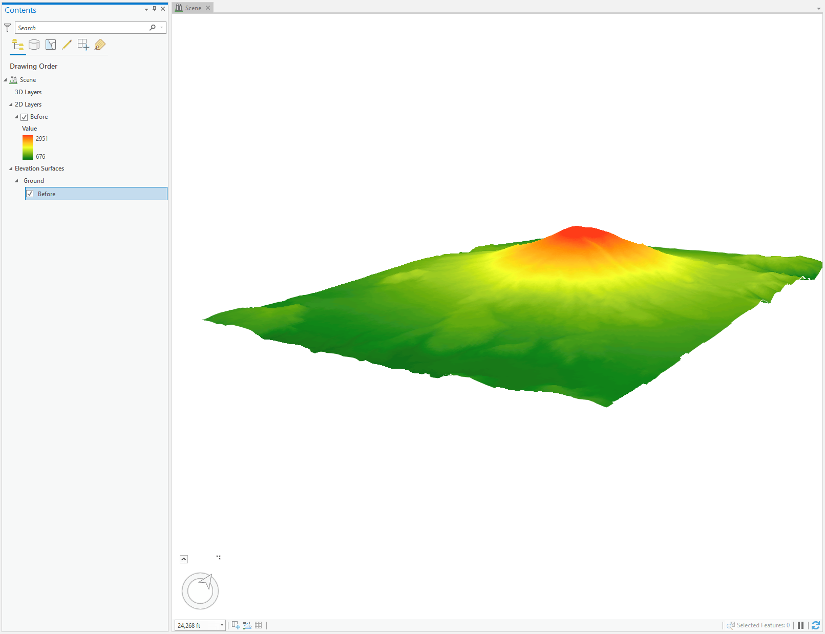

Now we can see the elevation data and raster data in the scene and we can now see what Mt. Saint Helens looked like prior to the massive eruption.

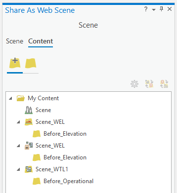

With all the layers added to this scene we can begin publishing a web scene and its layers to ArcGIS Online. With ArcGIS Pro 2.3 all you need to do is go to the Share tab, click on Web Scene and under the Share as a Web Scene pane we can see all the layers being generated when we share to ArcGIS Online.
ArcGIS Pro will auto-suggest the level of detail for the elevation and tile layers. You can adjust the level of detail by right clicking on the layers being published and clicking on Configure Web layer properties. Here I adjusted the elevation layer level of detail down to level 19 and the same for the tile layer created. Once the layer properties have been configured click on Share and the packaging and publishing process will begin.

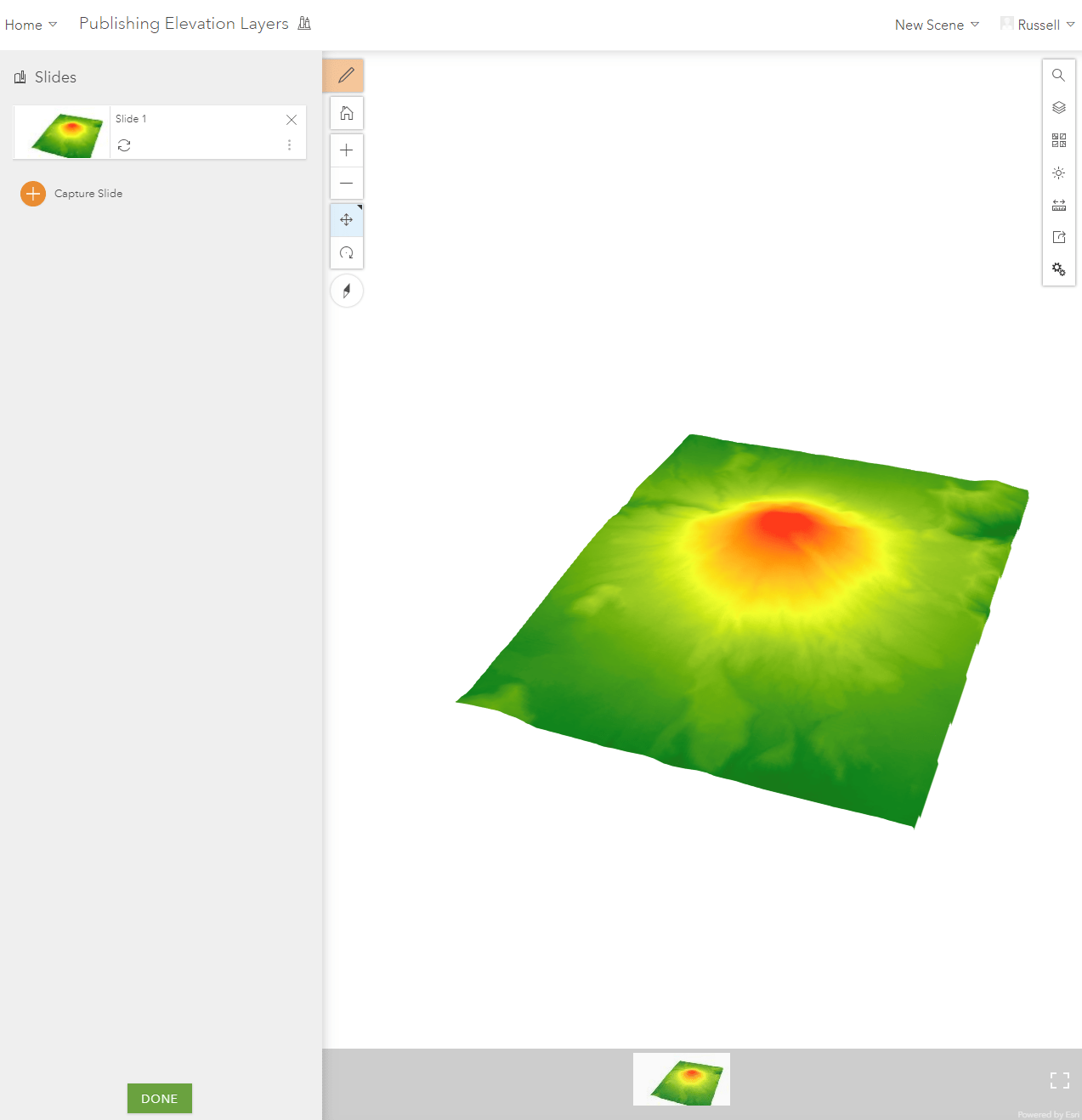

Now that the web scene and layers are all published to ArcGIS Online we can now view them in Scene Viewer. I can open the web scene by clicking on the link provided in ArcGIS Pro or open the web scene from the item located under My Content in ArcGIS Online.
Even though the web scene was created in ArcGIS Pro I can also make changes to this web scene in Scene Viewer. I can adjust the background of the web scene to just white so I see no blue sky in the horizon when I tilt the camera. I am also going to add a few slides to each this web scene to help viewers navigate my web scenes that might not be familiar with navigating in 3D. To create slides simply click on the Slides button in the Designer Pane, then click Capture Slide. This will save the current view you have in the scene. Once all the slides are captured just click Save to update the web scene.
