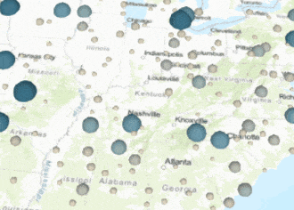

Point Scene Layers
A Point scene layer is composed of points in a scene layer. Using point scene layers allows you to add a large number of points into the web scene. The thing you will notice about point scene layers is the auto-thinning on the features within the scene layer. This means when you zoom away from the layer you will see a fewer points and as you zoom in closer more features will zoom in. This is done to improve the performance of the scene layer you are visualizing. You can also leverage the new smart mapping feature in the scene viewer on point scene layers.

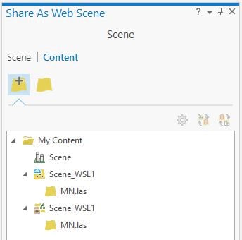

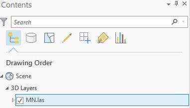

1.First you will need to have a scene open in ArcGIS Pro. You can use at least one of the supported layer types (Point feature class, Multipatch feature class or LAS data) under the 3D Layers category of your content in your scene that you want to share to ArcGIS Online
		2. Next you can right click on the layer and click on Share As Web Layer to share just the layer to ArcGIS Online or You can go to Share as a Web Scene to share the web scene and the layers together to publish everything at once. You can also choose to publish a scene layer with an associated feature layer for point and 3D Object or you can create a local cache in a scene layer package and that will be uploaded to ArcGIS Online and generate a scene layer. For point cloud scene layers there will only be the option to create the local cache.
		When you are ready to publish your scene layer click the share option and the publishing process will begin. You can track the progress of the scene layer generation under the Jobs pane in ArcGIS Pro.

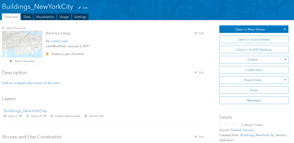

1.You will need to publish a feature layer with Point or Multipatch data. This can be done by uploading a zipped gdb or shapefile. You can also publish this layer type from ArcGIS Pro or ArcMap.

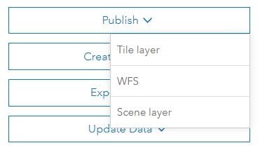

		2. On the item details for the feature layer click on the publish button and click on the Scene Layer option to begin publishing the scene layer.

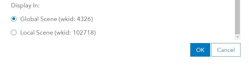

		4. In the publishing dialog you have the option to display this scene layer in a global scene or a local scene. For this scene layer I am going to select it to display in a global scene: 4326 (WGS84) because I want to use my organizations basemaps which are supported in global scenes. If I wanted to use this in a local scene I would have selected the local scene option with the projected coordinate system of NAD 1983 StatePlane New York Long Island (wkid: 102718).

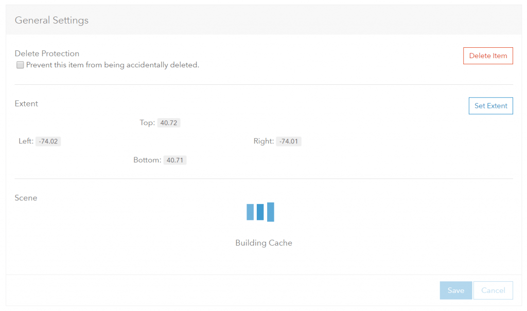

		5. The scene layer is now being published which is shown by the “Building Cache” notification on the item.
		Once completed you can then add it to the scene viewer through the item details or in the scene viewer itself by searching for it under My Content.
Publishing times can vary depending on many factors like the number of fields and attribute information in those fields, the number of layers within the feature layer and how the features were symbolized with textures or not. Some examples on times you can expect to see –21,000 multipatch features with no textures generated from building footprints with only one attribute took roughly 5 minutes to build the scene layer cache. A smaller feature layer of 3,500 points took 1 minute and 30 seconds with 7 fields. Also depending on the traffic/load on the system publishing times can be impacted.
