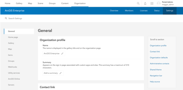

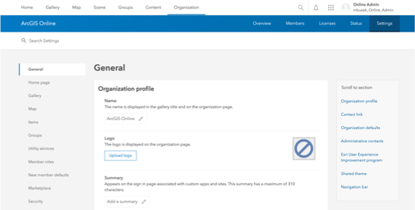

You may find that ArcGIS Enterprise and ArcGIS Online organizations look very similar. And that’s intentional! ArcGIS Online and ArcGIS Enterprise share many of their underpinnings, meaning the user experience between the two products is very similar.  Whether creating new data, new web maps, or new apps, your individual users may not know if they’re using ArcGIS Online or ArcGIS Enterprise. If you’re not sure which product you’re using, there is one easy way to tell: if the address shown in your browser includes arcgis.com then it’s ArcGIS Online. Otherwise, you’re probably using ArcGIS Enterprise.
ArcGIS Enterprise administrative user interface
The ArcGIS Enterprise portal and ArcGIS Online have a very similar look and feel.
ArcGIS Online administrative user interface
As we start to go beyond the user interfaces and look at how these products are built, the distinctions between the two products become more obvious. A central difference between ArcGIS Enterprise and ArcGIS Online is that ArcGIS Enterprise is software and ArcGIS Online is Software-as-a-Service (SaaS). Both software and SaaS have different advantages.

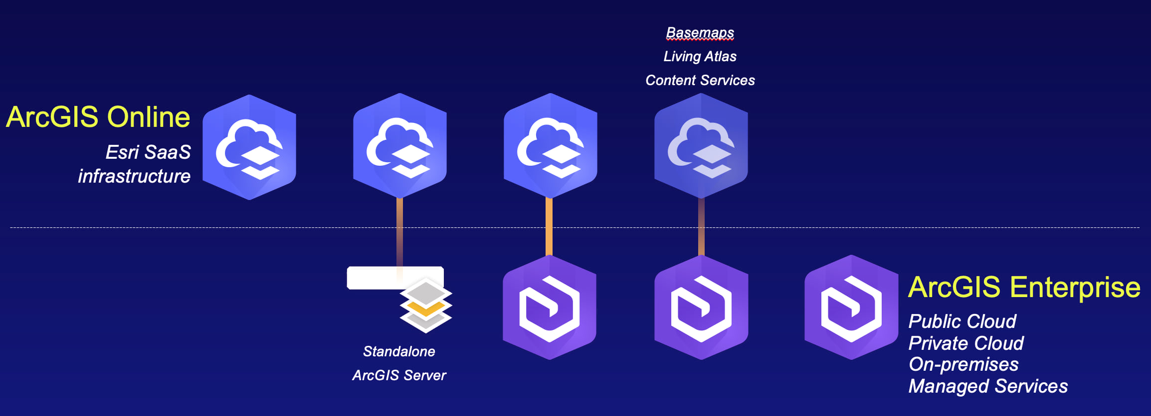

Patterns of Deployment for ArcGIS Online and ArcGIS Enterprise
There is a spectrum of deployment patterns for using ArcGIS Enterprise and ArcGIS Online.
The diagram above shows a spectrum of the patterns of use for ArcGIS Enterprise and ArcGIS Online. At the far-left end of the spectrum, a user’s needs can be met by simply using ArcGIS Online. On the far right, you’ll see all the additional pieces involved with ArcGIS Enterprise and how configurable it is based on your needs.
If you don’t need to run the software behind your firewall or in disconnected environments, you don’t need to store data in your enterprise geodatabases or other data stores, and you don’t want to worry about installing, upgrading, scaling, and managing the platform yourself then using ArcGIS Online, hosted and maintained by Esri, is a simple and straightforward solution.
At some point, you might want to disseminate internally managed data to people outside of your organization using ArcGIS Online. One option is to add ArcGIS Server web services to your ArcGIS Online organization. ArcGIS Server is a component of ArcGIS Enterprise, which powers the web services used in ArcGIS Enterprise. However, ArcGIS Server can also be used as a standalone component to power web services without ArcGIS Enterprise, such as in your own applications or in ArcGIS Online. To do this, you can publish web services to ArcGIS Server that reference your data in place and then add those services as items to ArcGIS Online. In this scenario, you are referencing your internally managed data in place, so people outside of your organization accessing the web service are seeing a live view of the source data instead of a copy.
If you want to have an internal system behind your firewall and then share data with the public, setting up Online and Enterprise through distributed collaboration with one another is a great solution. For example, you may need to expose ArcGIS Enterprise content to the public through ArcGIS Online, make data visible across different departments in an organization, or manage field data collections. Distributed collaboration allows you to use the two products together and extend the reach of your GIS content by seamlessly sharing maps, apps, layers, and more with other organizations via groups. With this hybrid setup, you can start to take advantage of some of the features of Enterprise alongside your Online organization. As we continue to move to the right side of the above diagram, distributed collaboration may be more than your organization needs. If Enterprise is your only system of engagement for your organization, you can still let your internal organizational users leverage ArcGIS Online utility services by connecting to Online and taking advantage of basemaps, Living Atlas, and more.
Finally, moving completely to the right side of the above diagram, your organization may have tight restrictions on network access and stringent operational requirements. As a result, you need to be fully behind your firewall and maybe even in a disconnected environment without internet access. In this scenario, you would choose to exclusively use Enterprise without a connection to Online. Here you would be reliant on your own basemaps and utility services.
With any of these collaboration options, you’ll want to consider the values and challenges of each pattern. Think about the manageability of each of these options and if they will deliver what you need for your workflows. There is no single pattern for integrating the two products, so you can implement them in the way that best suits your needs.
