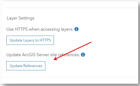

To update the site reference for layers in a map, go to the Settings tab in the map’s item page. In the Layer Settings section under Update ArcGIS Server site references, click the Update References button.

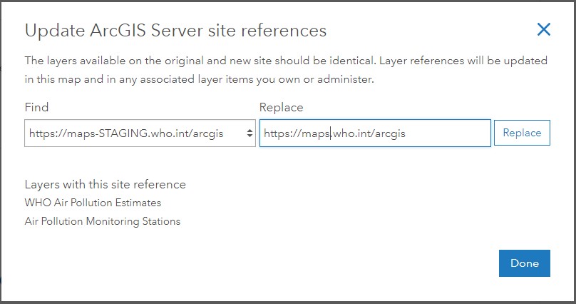

In the Update ArcGIS site references dialog, select the site reference you want to update from the sites listed in the Find dropdown. All layers that reference the selected site are listed on the dialog. The Replace input box is pre-populated with the current site name, allowing you to edit the existing site URL. When you’re finished, click Replace to update the site references in the map. All layers referencing the existing site will be updated to reference the new site.

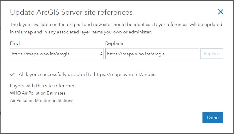

ArcGIS Online will check that the replacement ArcGIS Server site is valid. If it is, you’ll see a message indicating that the update was successful; otherwise, you’ll see a message indicating that the layers could not be updated. If this happens, verify that the replacement site URL is correct and accessible.
That’s it! Be sure to check your map to make sure everything is working as expected. If you see issues after performing an update, you can always revert to the old site using the same workflow.
