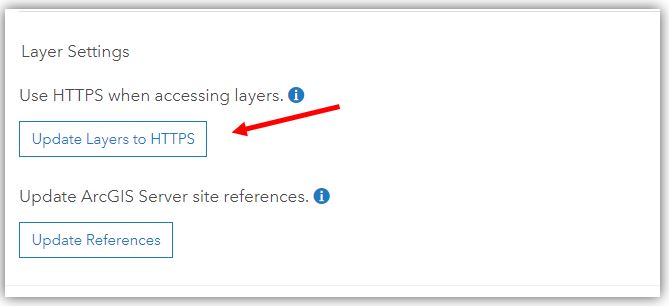

To update layers in a map to use HTTPS, go to the Settings tab in the map’s item page. In the Layer Settings section, click Update Layers to HTTPS.
After clicking Update Layers to HTTPS, a prompt displays to inform you that the layers in the web map will be updated to use HTTPS rather than HTTP, and that any layers in the map that reference layer items you own will also be updated to HTTPS. Note, if you do not own the referenced layer item but do have privileges to update it, the layer item will be updated. For instance, if you are an administrator in your ArcGIS Online organization, you can update both a map that you don’t own and the layer items referenced by the web map.
To proceed with the update, click Update Layers.

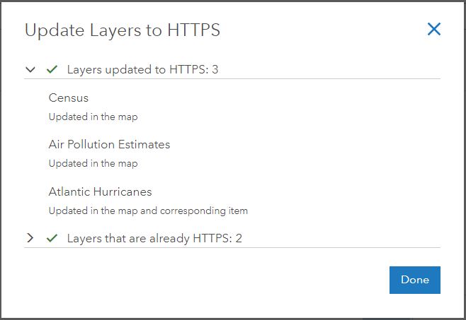

When updating layers to use HTTPS, ArcGIS Online will check each HTTP layer to make sure it supports HTTPS. Once all HTTP layers are checked, the web map will be updated to use HTTPS for all layers that support it. Once complete, you will see a report indicating which layers were successfully updated to HTTPS. Layers that were already HTTPS are reported as well. The report will also indicate if any associated layer items were updated to HTTPS.
That’s it! The layers in the web map should now use HTTPS when you view the map. Check the map by opening it in an HTTPS browser session (simply change the url from HTTP to HTTPS if your web map is not loaded as HTTPS already) and verify the layers draw as expected.
If a layer does not support HTTPS, you are notified that the layer could not be updated. To update the layer, the server providing the layer will need to be updated to support HTTPS. Once updated, the layer in the web map can then be updated to use HTTPS.
