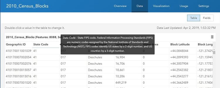

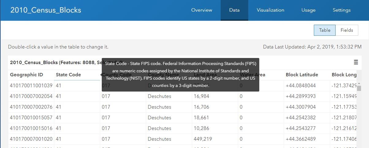

Where do you see field descriptions?
The most prominent display of field descriptions is on the item details page of the layer, on the Data tab. When looking at the attribute table, moving the mouse over a field header will display the field name and description.

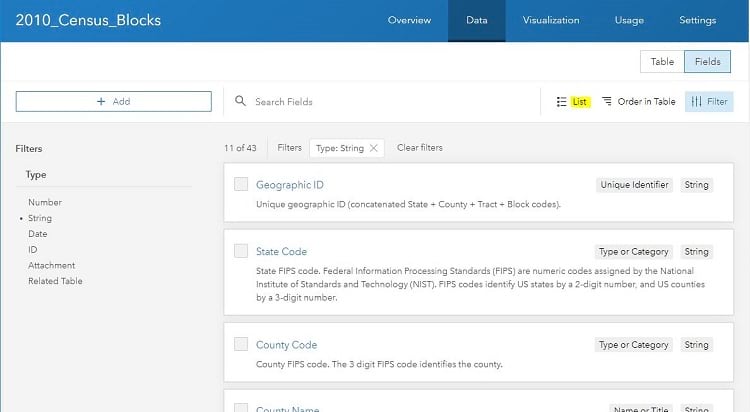

In Fields view, you’ll find a new ‘List’ option that shows field descriptions and field value types for all fields. List view makes it easier understand what attributes the layer contains. Table view is still the default view for your layers, but list view is now the default view for layers shared by others.

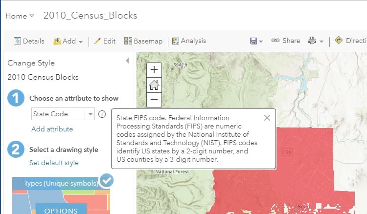

To help you pick the right field for drawing, you can access the field description right from the Change Style panel within the map viewer. Keep this in mind when authoring your own field descriptions, as a meaningful tip about the attribute values can help others draw your layer effectively.

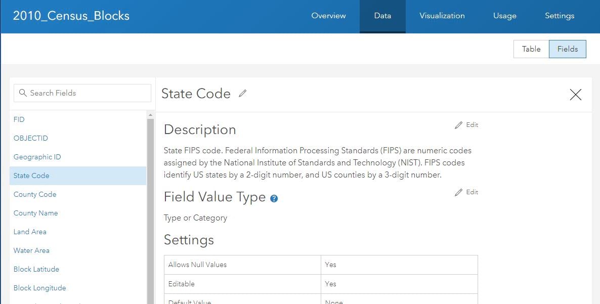

How do you set field descriptions?
When viewing fields on the data tab, click on a field name to reveal its properties. Here’s where you can configure the new description and field value type.
