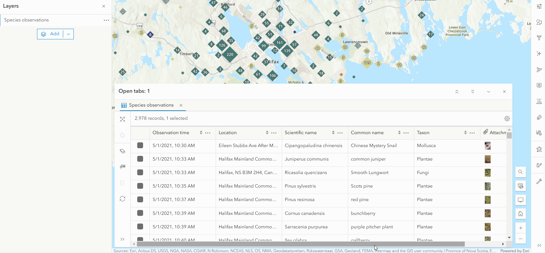

Attachment viewing
The attribute table attachment column displays the count of a record’s attachments and provides a snapshot of those attachments by previewing the first 8. Clicking on an attachment cell brings you to a full list of a record’s attachments. In the list, you can perform several actions, including downloading or viewing an attachment.
Clicking View attachment (updated in February 2026) takes you to a dedicated view of the selected attachment. Here you can review attachment information, like attachment type and keyword. Additionally, if the attachment is an image, you can now view them directly in the table. For large images, click Maximize to view them in a full-page experience. These updates allow you to streamline your review process while staying within your working browser tab.

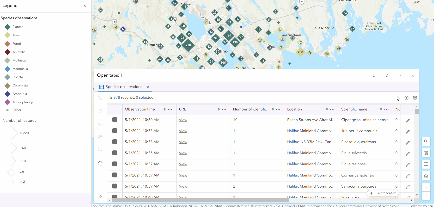

Configuring column visibility ensures that your audience has the information they need to understand the dataset and draw conclusions. Column visibility can be set on fields, attachment columns, and related record columns. In the species observations map below, I’m refining the attribute table to match the map theme by only including species identification information, like species names, identification agreement/disagreement votes, and attachments.
Configuring field visibility.

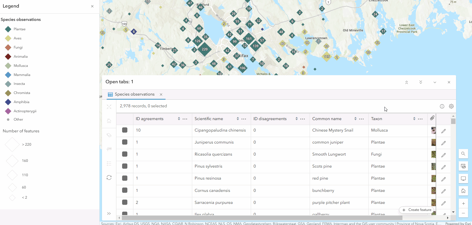

Column order
Setting column order allows you to prioritize important information and help your data flow. You can also improve readability by placing related fields together. For example, below I’m reordering the fields so that the number of identification agreements is beside the disagreements for easy comparison.
Ordering fields by dragging and dropping them into desired positions.

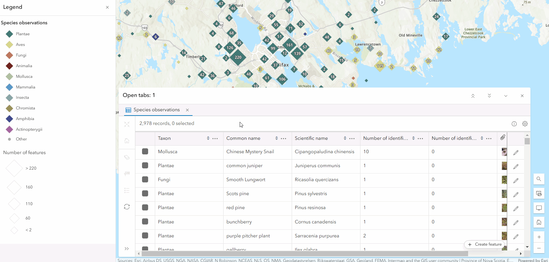

Data sorting
Sorting field data, in ascending or descending order, helps organize the data in a meaningful or intuitive way and can help highlight patterns. For instance, I can sort the taxon field so that the records are grouped by taxon like they are in the map.
Sorting taxon field in ascending order.

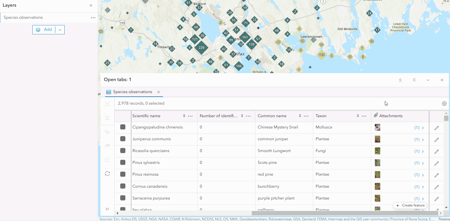

Persisting table configuration
Save the web map once you’ve made the desired changes to the column visibility, order, and sorting. This will ensure that others viewing the map will see the attribute table as you configured it. If you want to reuse the attribute table configurations set on a layer in other maps, save the changes to the layer item through the properties panel. For more details, see the layer properties documentation.
