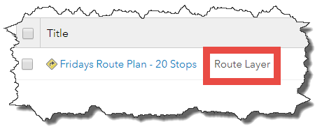

Answer: The Route Layer.
A Route Layer is an item type within ArcGIS Online. Route layers can be created from the ArcGIS Online Directions Pane and ArcGIS Online Analysis tools with network analysis capabilities – Find Nearest, Plan Routes, and Connect Origins to Destinations. …And in the future, ArcGIS Pro (2.1) and ArcGIS Enterprise 10.6 will be able to save network analysis results as route layers.

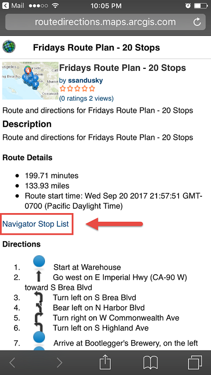

You can then view the route layer item on your mobile device, and click the “Navigator Stop List” link. This will automatically load all your route’s stops into Navigator.

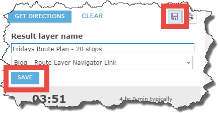

- Step Two – Save your route
Give your route a useful name, and store it in a folder so that you know where to find it.

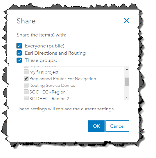

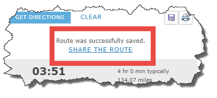

- Step Three – Share your route
The SHARE THE ROUTE link takes you to the route layer item details page, where you can choose to share the route with everyone, your org, or a specific group in your org. For this example, we’ve shared the route publicly (so it’s available to you), and shared to a dedicated group for field workers (to show how a group can be used within your organization).

- Step Five – Open the link on the mobile device. Note that you must have Navigator installed, a map downloaded for the area of your stops, and that map must be opened within Navigator. Enjoy!

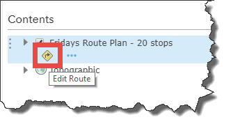

Note 1: Any route layer item created before the September 21, 2017, release of ArcGIS online will not contain the Navigator app link within it. If you want to add the Navigator link to an existing route layer item, you can edit the route with the Direction Pane and re-save it. To do this, add the route layer to the Map Viewer, choose to Edit Route, and then re-save the route.
