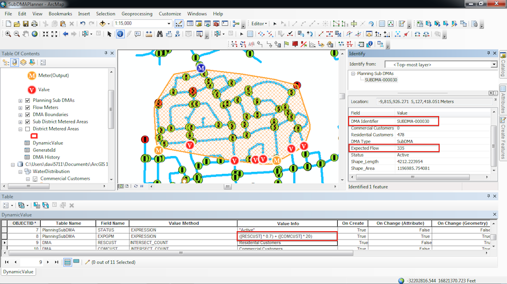

1.    Sub-DMA Planning Map (ArcGIS for Desktop app) – Engineers plan and create sub-DMAs with the Sub-DMA Planning Map app. Using the app, the engineer selects the valves to be closed and the meters that will be used to monitor the flow. Then that engineer runs a preconfigured model that defines the boundary, created with a unique name and the expected flow. Based on a configurable calculation according to customer type (i.e., household or nonhousehold), the expected flow doubles as the expected consumption and expected minimum nighttime flow value. Once satisfied with the results, the engineer runs another preconfigured model to save the sub-DMA to a layer, which gets used in real-time with the other apps.
Sub-DMA Planner creates unique sub-DMAs with expected nighttime flow based on configurable calculation

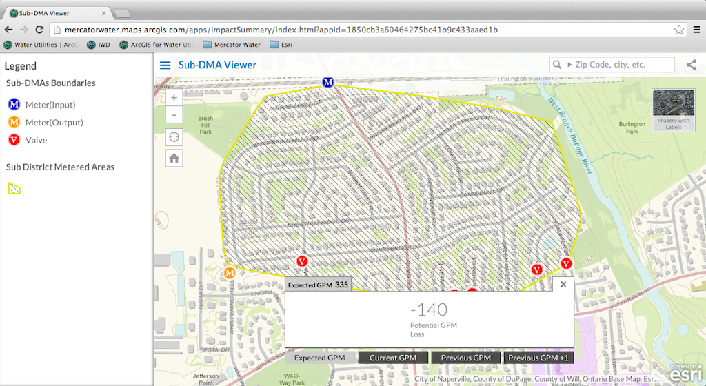

4.    Sub-DMA Viewer (browser-based app)  Meanwhile, engineers can use the Sub-DMA Viewer to monitor expected and current gallons per minute (GPM) of sub-DMAs. In this viewer, the expected GPM equals the expected consumption calculated during the sub-DMA planning and creation (app #3 above); the current GPM equals the Observed Flow that was updated in the field using the Sub-DMA Nighttime Flow Updater App. Clicking on the expected GPM in the viewer pulls up the estimated loss for that sub-DMA. The app also provides a brief history of change by showing two previously observed values for the sub-DMA selected.
Sub-DMA Viewer showing potential loss in GPM
