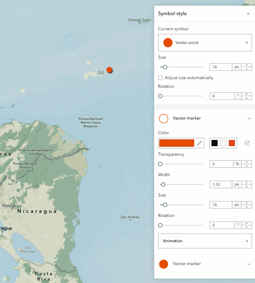

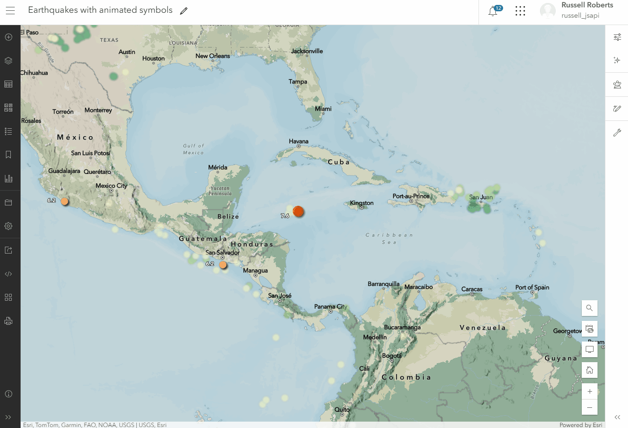

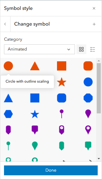

This first map shows recent earthquakes classified by magnitude. Updating the Mag > 7.5 class from the standard circle to one of the new animated symbols. Opening symbol styler and clicking on the Animated category will show the list of available symbols inside this web style. Clicking on the circle symbol with an outline scale will make a great fit for this map and will show an example where multiple animation types are being used in a symbol layer.

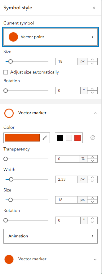

The outline symbol layer will use scale and transparency animations. Throughout the set duration of the animation the outline symbol layer gets increased by a set scale by a factor and have the transparency increase from 0 to 100% which will make the outline appear to fade away as the symbol layer increases in size.
Clicking on the Animation button will show you the available controls for the animations on the symbol layer.

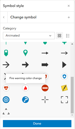

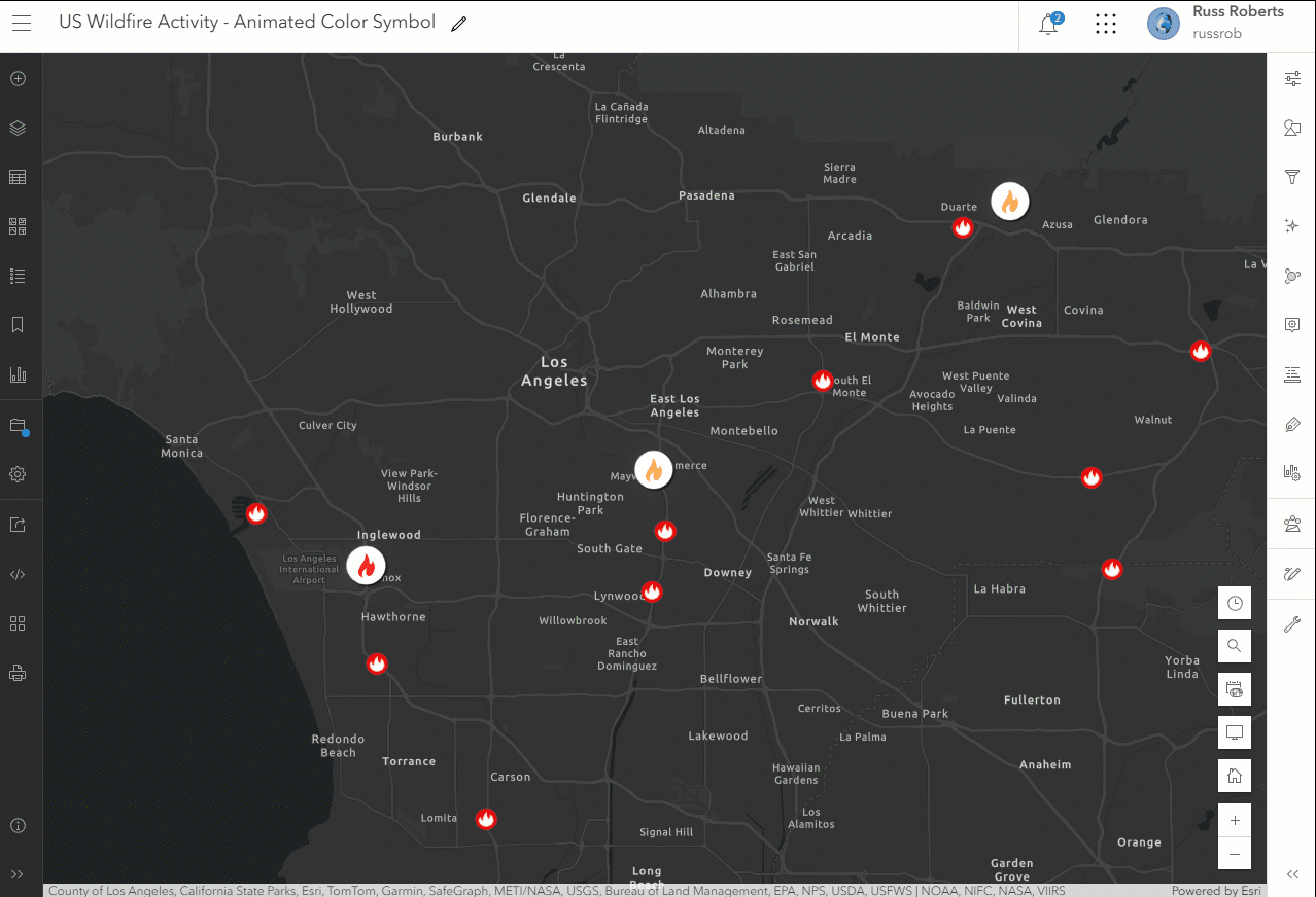

In this sample using the recent fires layer from the living atlas we can use the Fire warning color change symbol from the Animated gallery.
This symbol uses the color animation. Clicking on the Animation button you will see this symbol uses just the color animation property. Selecting a new color will transition from the original red color used on the symbol to a new color selected in the color picker. Adjusting the timing offset to randomize also gives this visualization a more natural feel and is less hypnotic with the features animated.

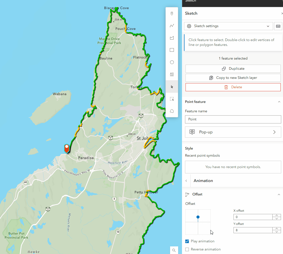

Animated symbols also work with sketch layers. Here I have a section of the east coast trail located in Newfoundland. I can use the animated pins within the style to draw your attention to the start and end locations of the trail. The offset uses the same XY slider you see with drop shadow layer effects and label placement. Using the slider, you can control how the pin moves away from the origin point.
