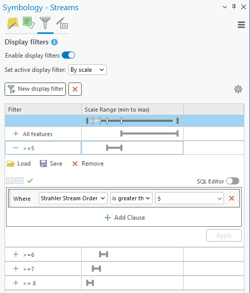

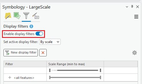

Next, click on Enable display filters. The scale display filter is the default type that will be enabled.
The <all feature> display filter will be present when a new display filter is created. Clicking on the topmost scale range slider can adjust the range for the all feature display filter. The name can be updated, along with adding a new expression.

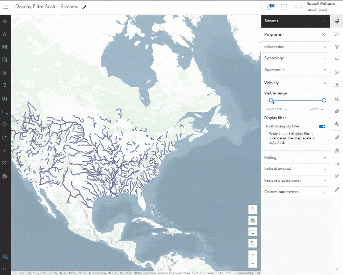

Clicking on the New display filter button will add a display filter below it along with adding a new slider handle to the top most scale range. Similar to the all feature display filter you can adjust the range and expression for this display filter. For this example, layer I set the scale display filter on stream order so as you zoom into the map more streams of lower order are displayed.
Once the display filter has been completed the map can be shared to ArcGIS Online and Opened in Map Viewer. The display filter will be active and you and see zooming in the display filter adjusting for the map scale. Opening the layer properties panel, you can control if you want the display filter to be active on the layer or not.

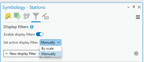

Manual display filters are available on the same panel where the scale-based steps are outlined. When on the display filter panel, the type of active display filter can be switched from scale to manual by clicking on the available dropdown.

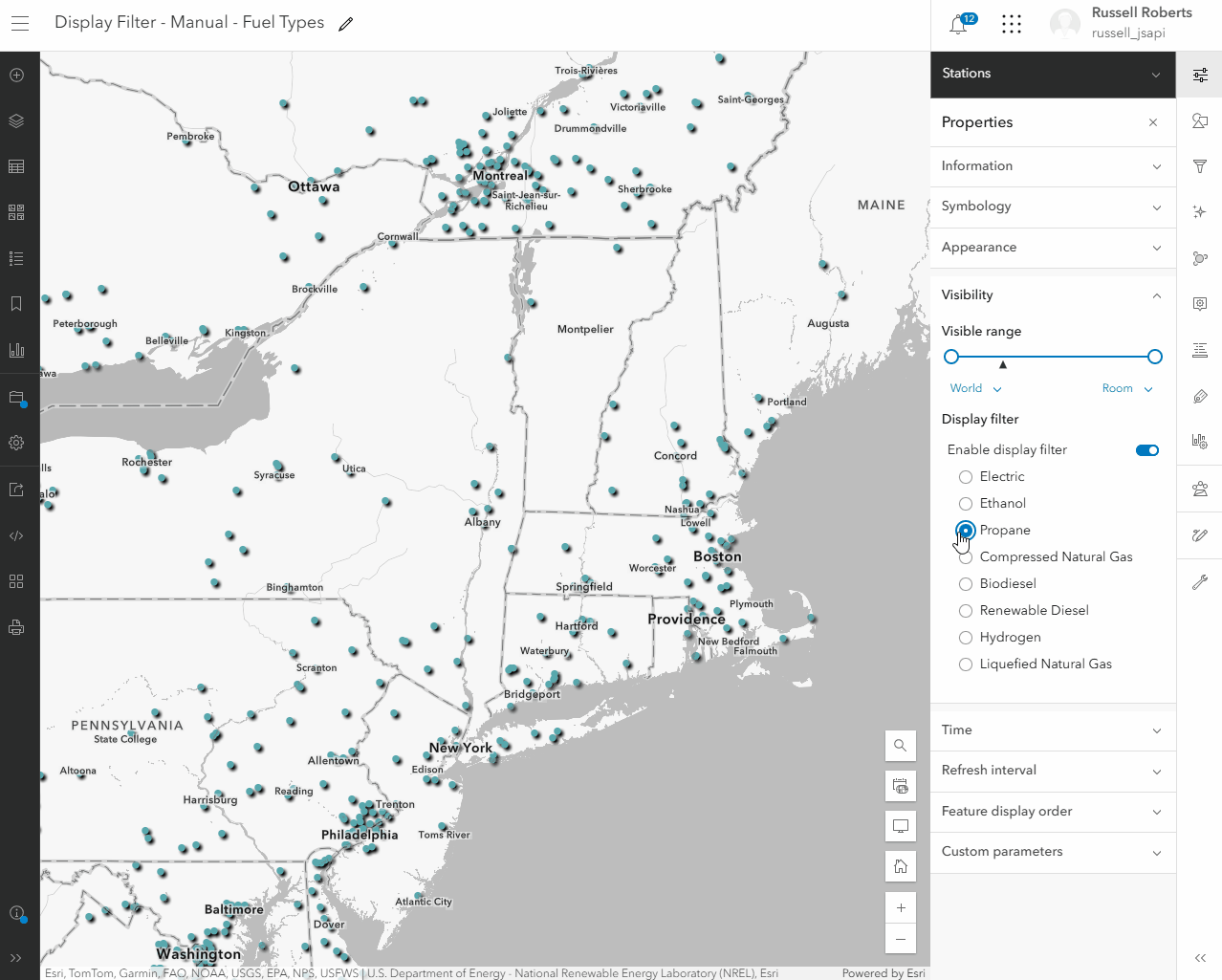

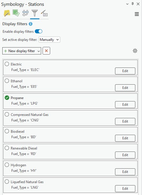

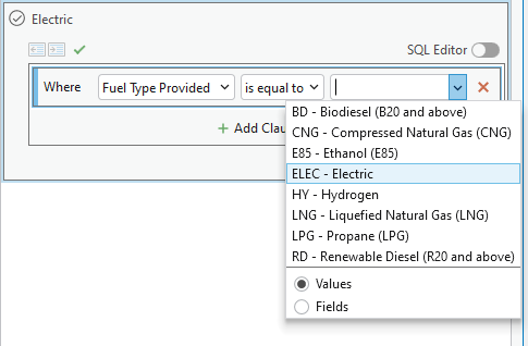

Similar to the scale display filter an all features filter is present. This can be edited by defining a new expression on the display filter. It is important that a name is added so the viewer of the map can understand what features are filtered out. Adding more filters is done by clicking on the New display filter button. In this example, I am adding a simple display filter on the field containing the energy station fuel type. We can easily compare the fuel types available on this layer one at a time.
Below is an image of the final list of display filters authored where the viewers of the map will have multiple energy types to pick from.
Share the final map to ArcGIS Online and open the map in Map Viewer. On the layer properties panel, you will see under the display filter section all the filters created. Clicking on a filter will set the active display filter. The top-level toggle on the display filter section in the panel will also enable or disable it completely on the layer.
