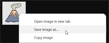

Right-click to save the image to your local drive. Options you see will depend on your browser. Shown below are the options when using Chrome.
Save image

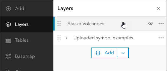

Step 3 — Open the Layers pane from the Contents (dark) toolbar. Ensure that the Alaska Volcanoes layer is selected.
Select layer

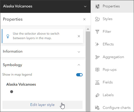

Step 4 — In the Settings (light) toolbar, open the Properties pane and click Edit layer style.
Edit layer style

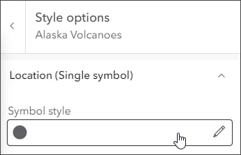

Step 5 — The layer is symbolized using a single symbol. Click Style options in the second section to continue.
Pick a style
Step 6 — Click to edit the current symbol style.
Edit style

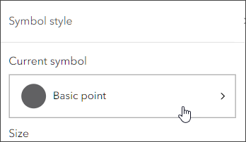

Step 7 — The current symbol is of type Basic point. Click to change it.
Basic point

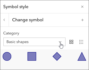

Step 8 — Click the Category drop-down.
Category drop-down

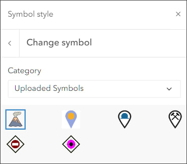

Step 9 — Scroll to the bottom and choose Uploaded Symbols.
Uploaded symbols category
Step 10 — Drag and drop your image, or click Browse to select it.
Add symbol
Note: Uploaded symbols will persist until you clear browser cache, so you can go back and reuse them. Uploaded symbols cannot currently be saved for other members of your organization to use, members must add them from local files as described above.
Uploaded symbols
Once added, any uploaded symbols can be sized, rotated, and have effects applied like any other symbol.

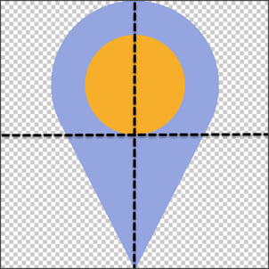

You can create your own image to use as an uploaded symbol. Symbols can be authored using any graphics program. Use a PNG or GIF for a transparent background. PNG provides the best overall results.

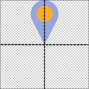

Something to consider is that the center of the image is placed on the x,y point location. For example, the symbol below will be placed with its center (where the dashed lines cross) on the x,y location of the point on the map.
Image center
To place the bottom tip of the symbol on the x,y location, create a symbol as shown below, placing the tip of the “tail” at the center of the image.
Image center

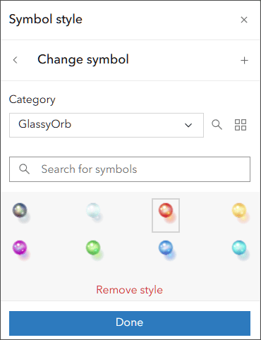

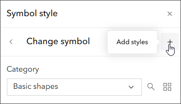

Step 4 — In the Symbol style pane, click + to add a style.
Add styles
Step 5 — Locate and select the style by checking the box in the upper left corner, then click Add.
Add style
View larger image

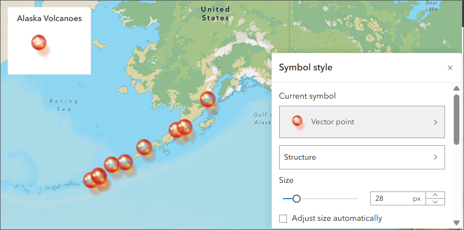

Step 6 — Once the style has been added, select a symbol, then click Done to apply it to the layer.
Choose symbol from style
You can adjust the size, rotation, and other properties just like any other symbol.
Use symbol from custom style
View larger image
