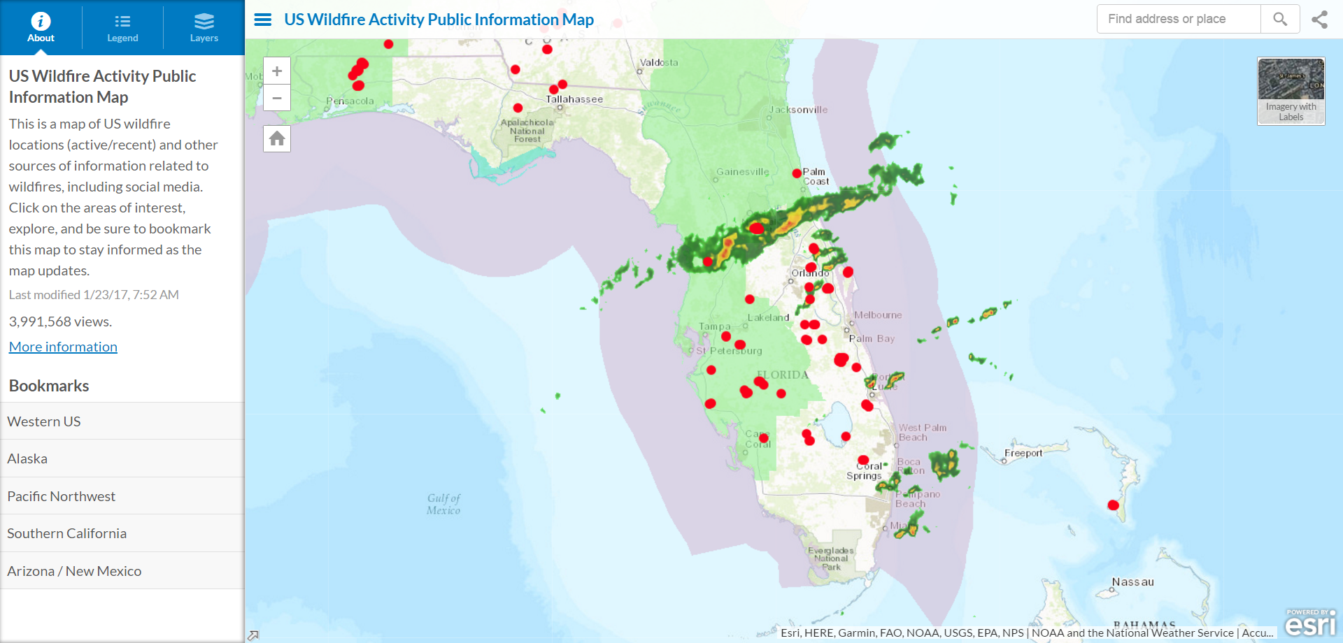

Consider a natural disaster, where apps are created to inform the public of evacuation zones and shelters. These apps may receive hundreds of thousands of views in a matter of days, receiving a high amount of web traffic. In order to ensure that these apps are performing at their best under high demand, consider these best practices for layer management, so ArcGIS Online can handle the rest.

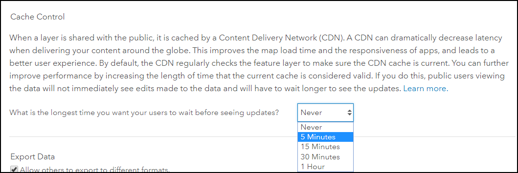

- Increase the Cache Control to at least 5 minutes (where applicable) for the layer
Increase Cache Control
When a layer is shared with the public, it is cached by a Content Delivery Network (CDN). The Cache Control is a service setting that determines how long a service response is stored by the CDN. By default, the CDN checks back to the service with with every request to look for new updates. If this value is increased, the CDN will not check back to the service for updates the time specified. This reduces the load on the server improving the scalability and performance for layers under load. We recommend setting this value for feature layer where data is not updated more often than once a minute.
Instructions to enable control cache setting:
- Navigate to the Settings Tab of the feature layer and Scroll down to Cache Control
- Select the appropriate amount of time based on your data update schedule
Tip: If you noticed the setting is disabled, ensure that the layer is shared publicly and editing is disabled and for the hosted feature layer view that is included in the public application.

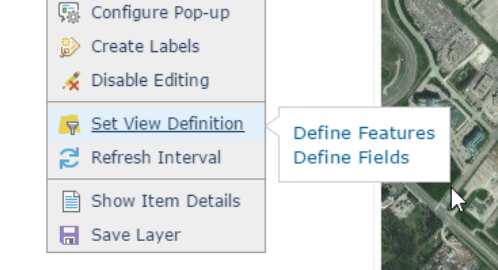

Many apps, especially in the emergency management space need to show updating data, requiring the ability to edit and display data in an easily scalable way. The December 2016 release of ArcGIS Online, introduced the ability to create hosted feature layer views. This allowed data owners to create an editable and uneditable view to achieve this requirement. The March 2017 release added the ability to set view definitions, allowing data owners to specify the features and fields displayed in each view.

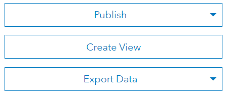

Next, create a hosted feature layer view that it is optimized for high demand.
Navigate to the Primary layer that you just created and select the Create View button.- Name the layer something that is easy to identify like Shelters_ display
