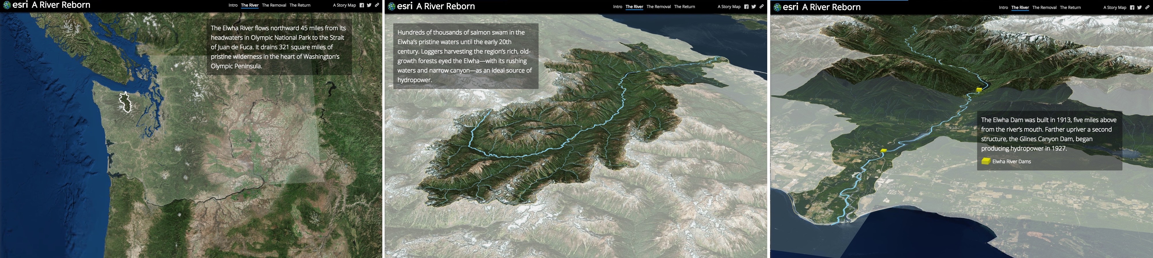

For example, open the River Reborn story and scroll through the web scene in its first section. It gives the reader geographic context for the story by first showing a view of Washington state and the location of the Elwah River and then showing two perspectives of the river itself, the second of which shows the location of two dams. Imagine what a different experience this would be if the author had just added the scene to the story and asked the readers to navigate the scene and toggle layer visibility on their own.

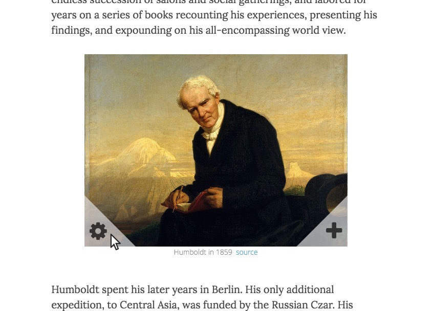

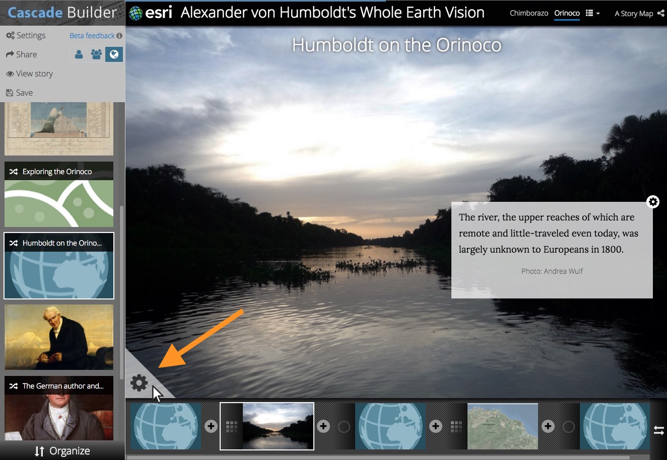

After you add media to your Cascade story using the builder’s Media Picker, click the gear icon in the lower left corner to activate its configuration panel.
If the media is in a narrative section, hover over the media to see the gear.

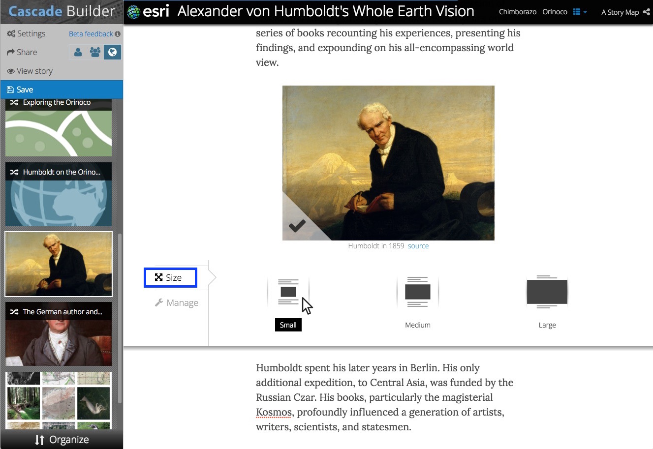

Size
If your media is in a narrative section you can adjust its size. The larger the size the more space you provide for your readers to see or explore the media (you’ll learn more about letting your readers explore later in this post).

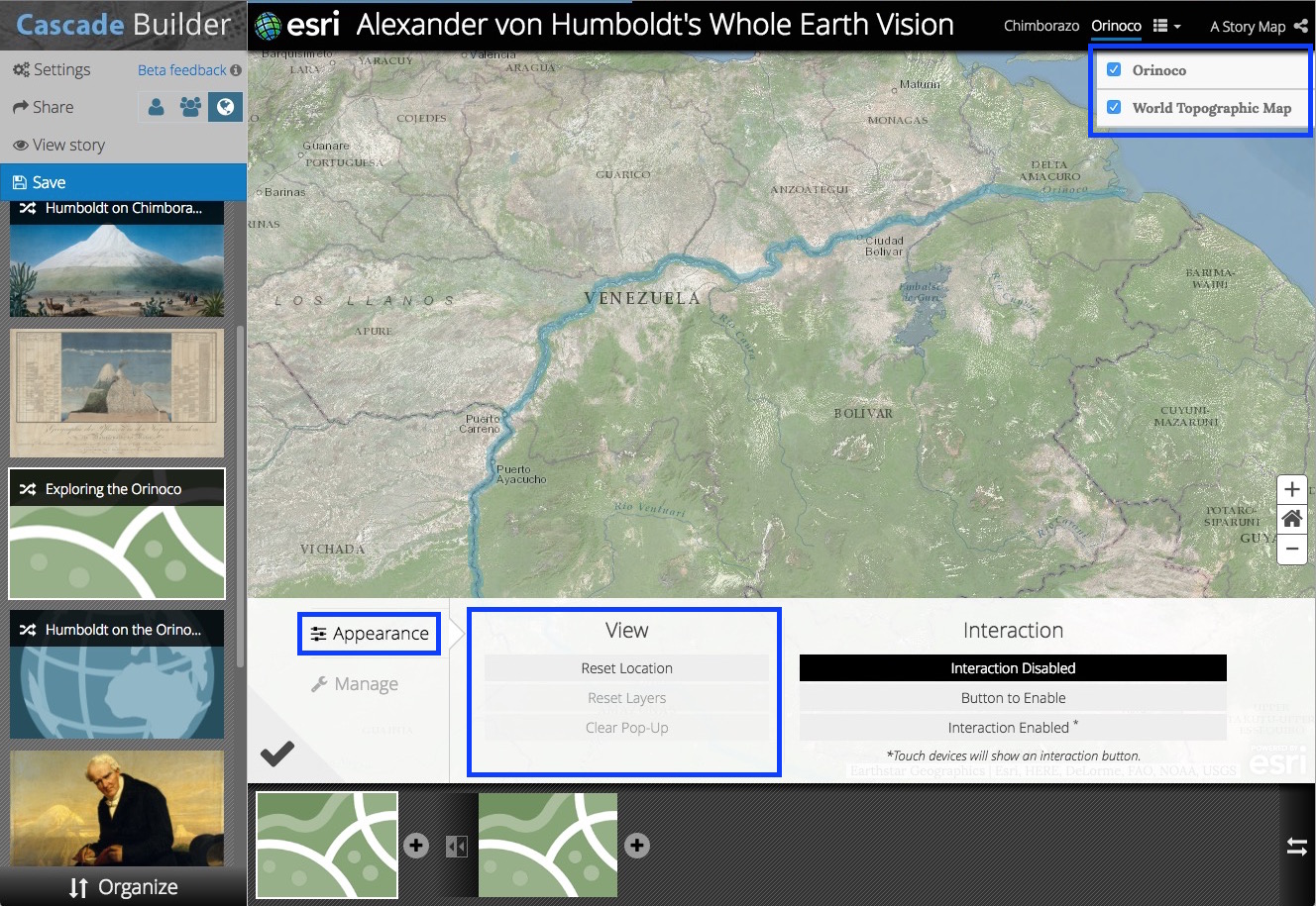

View (maps)
There are three aspects of a map’s view that you can configure: the location, the layers, and whether a pop-up visible.
Any changes you make to the map in the configuration panel will be saved when you click the checkmark to close the panel.:
If you need to start over, click Reset Location or Reset Layers to go back to the saved state of your web map. Click Clear Pop-up to close the pop-up.

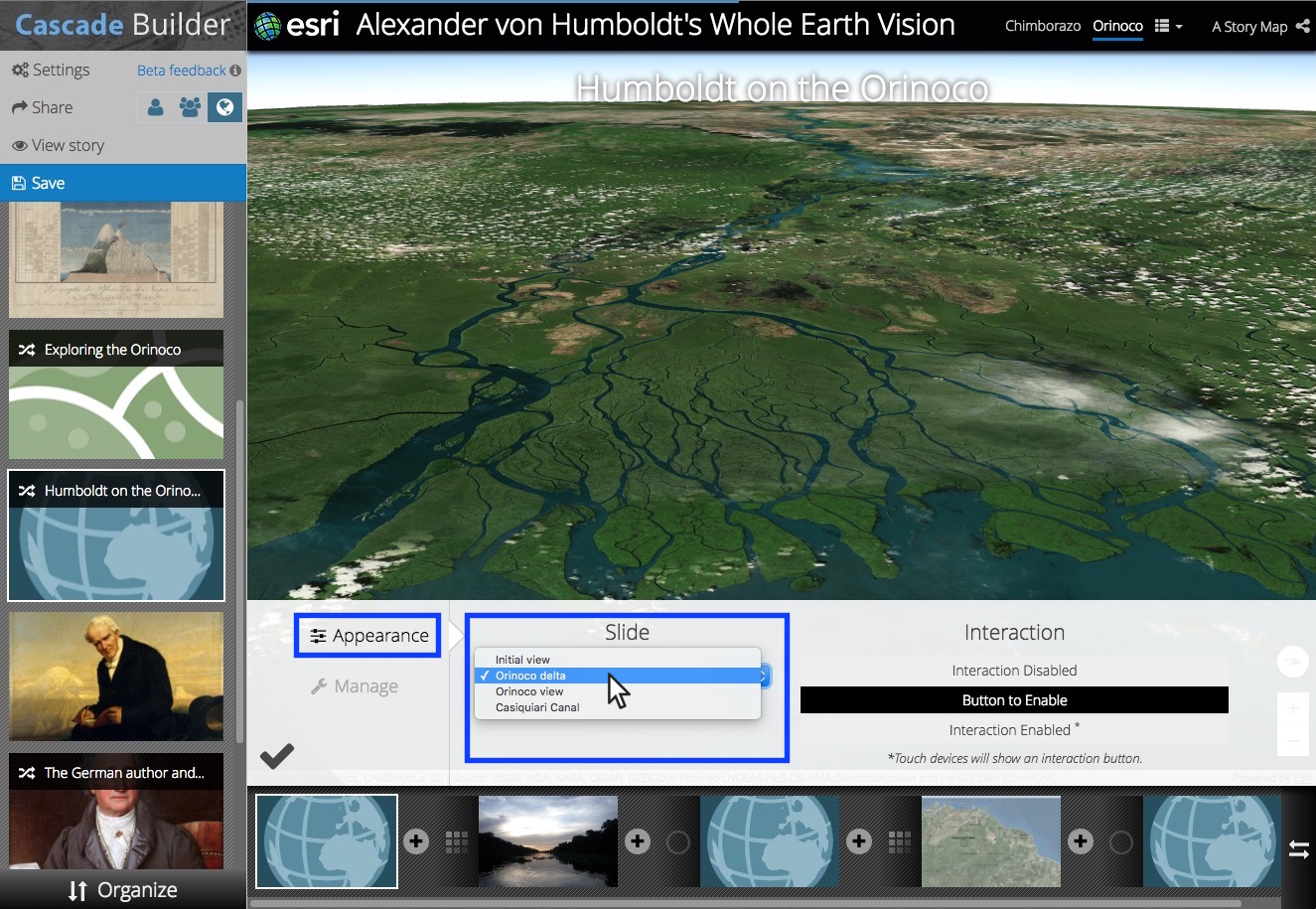

Slide (scenes)
When you add a scene you can select which slide is shown. Slides capture a 3D perspective, a set of visible layers, and other visual aspects of your scene. Pick a slide from the list to show that perspective and set of layers at the current point in your story.

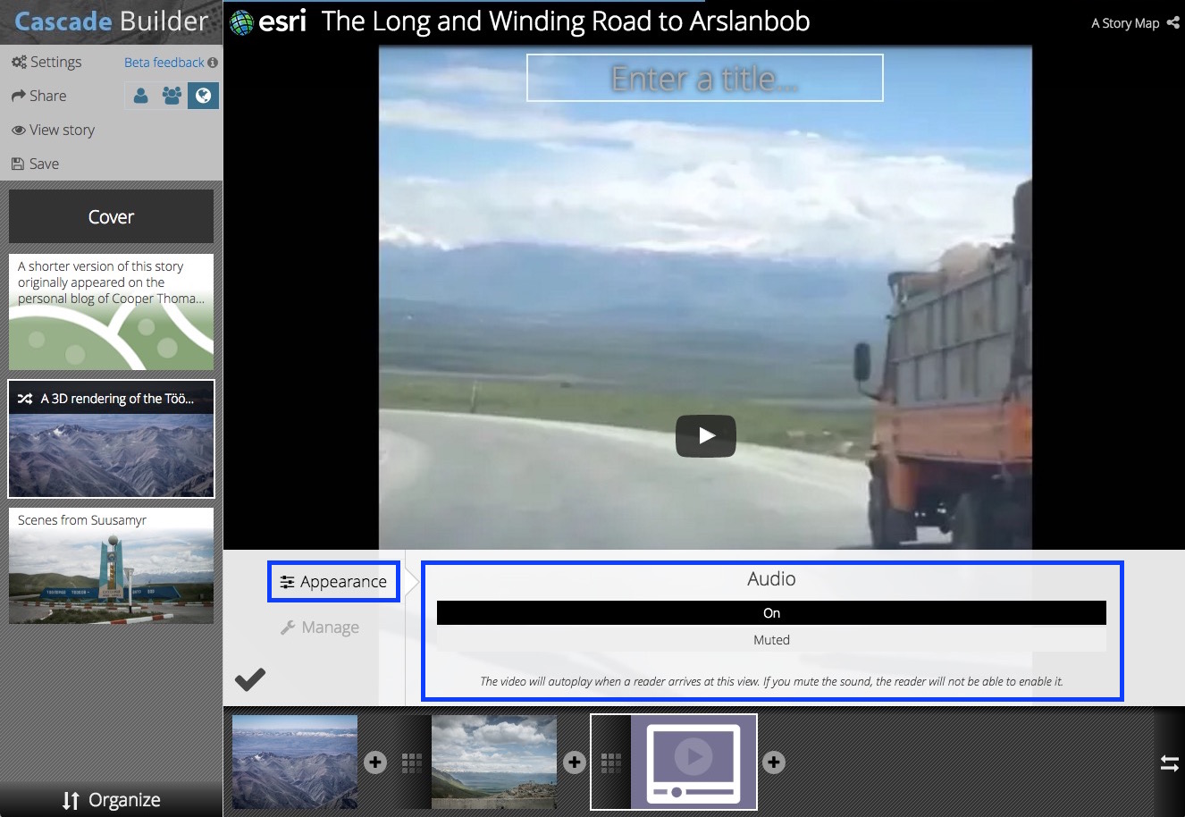

Audio (videos in immersive sections)
For videos in immersive sections you have a choice if you want audio enabled for your readers or not. If you mute the audio readers will not be able to enable it.

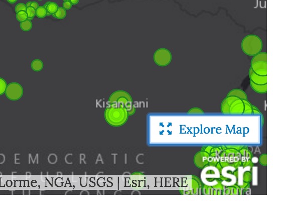

Interaction (maps, scenes, web apps, and web pages)
Depending on the media item’s role in the story you may or may not want your readers to interact with it. The best stories usually present readers with what they need to understand the narrative and let them explore in directed or limited ways.
The three options for interaction are:
Here’s what the interaction button looks like when it’s enabled for a map or scene.
Regardless of which option is selected you can always interact with the media when the configuration panel is open. If you click the checkmark to close the panel the selected option will become active.

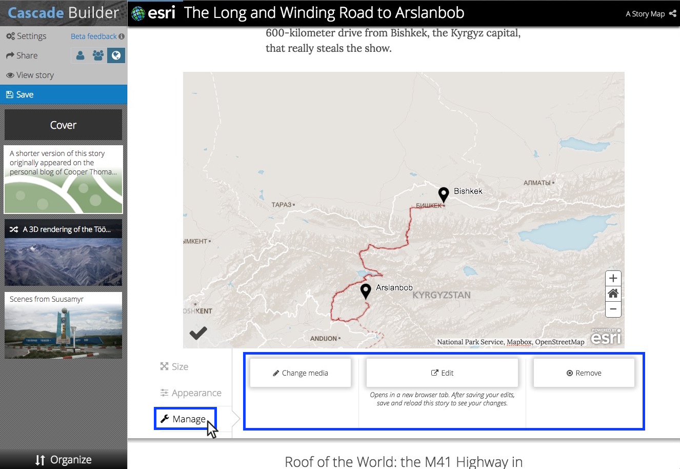

Manage
The last tab of the configuration panel helps you manage your media item. Use the Change Media button to swap the current item for something else; for example, you could pick a different map, change a map to a scene, or change a scene to an image. If the media is in a narrative section you can Remove it from the story. (If you need to remove media in an immersive section just delete the view.)
If you need to make changes to your geographic content use the Edit button to open the map or scene in the arcgis.com viewer. Since the location and visible layers can be adjusted in the builder, you only need to edit an item to make changes like adding a new layer or adjusting layer styling, changing the basemap, modifying pop-ups, or adding new slides to a scene.
