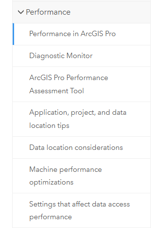

Performance section
This group of topics is a great place to start learning about performance in ArcGIS Pro.
There are sections for performance related tools such as the ArcGIS Pro Diagnostic Monitor and the Performance Assessment Tool (PAT). These tools can identify performance issues on your system.
There are other topics to help you consider how your data and its location may affect your organization’s performance.
Finally, there is a topic that describes settings in ArcGIS Pro that might affect performance as well as user experience. Use these latter groups of topics to help you make decisions when configuring maps in ArcGIS Pro.

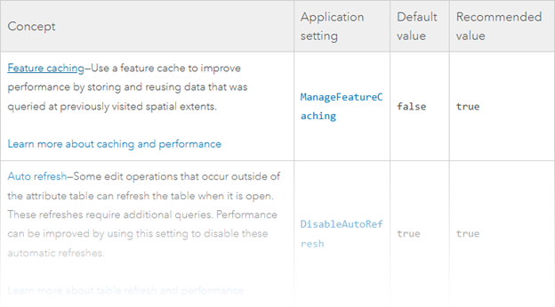

What’s in the table?
The Concept column on the left has a link to the help topic for the setting along with a brief description of the setting. At the bottom of each cell in the left column is an additional link that describes the setting in a performance context and explains how it might affect performance on your system.
The Application setting column contains a link to the application setting topic and describes the application setting name and provides an example of how to set it.
The Default value column is the value that is set if you take no action or do not set the value.
The Recommended value column is the value that we recommend for that application setting. We have recommended the most aggressive settings to optimize performance. Note that not all of these recommendations differ from the defaults.
Application settings table
