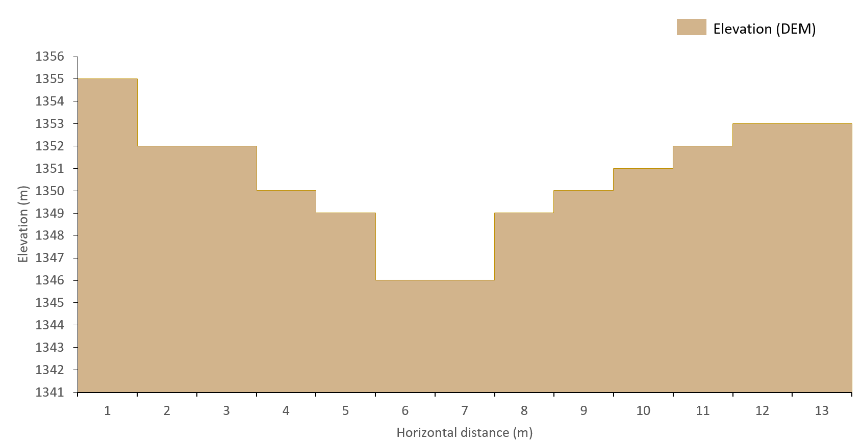

Figure 1 shows an elevation profile through a sink in a hypothetical DEM.
Single sink elevation profile
Figure 1. Elevation profile of a single sink.

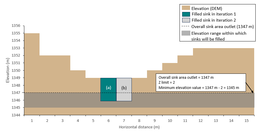

Using the Z limit equal to 2 example, a single sink (illustrated below in Figure 3) labeled (a) would be filled up to 1349 m which is the elevation value of the lowest adjacent neighbor. After having filled (a), the single sink labeled (b) would also meet the two conditions, and so it is also filled up to 1349 m.
Filling single sinks in a DEM
Figure 3. Single sinks are filled using the Fill tool up to the elevation value of the lowest adjacent neighbor.

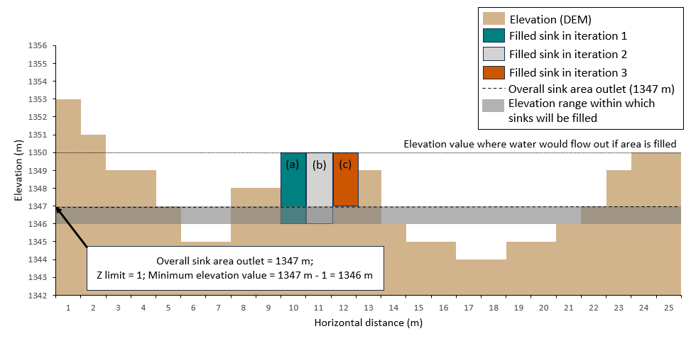

The same iterative process is applied to nested sinks – the only difference is the elevation value up to which a sink is filled. For nested sinks, this value is that of the overall sink area outlet. Like in the previous example, after a single sink is filled, neighboring cells may now meet the necessary conditions to be filled and thus will be filled. This is the case of sink labeled (c) in Figure 4 below. After (b) has been filled, (c) now meets Condition 2 – it has a lower elevation value than the lowest adjacent neighbor. Since it originally met Condition 1 (depth below the specified Z limit), it now meets both conditions, and it is filled.
Filling sinks within a nested sink structure.
Figure 4. Sinks are filled using the Fill tool up to the elevation value of the sink outlet.
