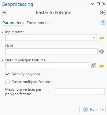

Raster to Polygon tool UI in ArcGIS Pro
Figure: Raster to Polygon tool UI in ArcGIS Pro
First, decide which parameters to use before doing the conversion. If the raster has many unique values, for example, a digital elevation model (DEM), then leave the Create multipart features option unchecked. When it is checked, all the geometry is kept in memory until all the data is processed before writing it to disk, and this can cause the tool to fail when insufficient memory becomes available.
