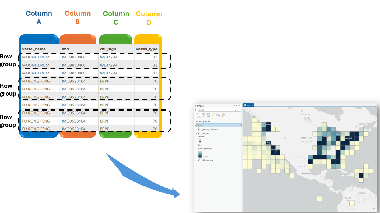

ArcGIS Pro 3.5 includes new and updated capabilities for geospatial visualization and analysis. One feature of this release is the enhanced support for Apache Parquet files. Parquet is a cloud-friendly columnar storage format optimized for efficient data access and analytics. It is highly compressible and self-describing, with embedded metadata and column-level statistics allowing for selective reading and quicker analysis. Widely adopted in cloud analytics workflows, Parquet is used by frameworks like Apache Spark to enable parallel processing in distributed environments.

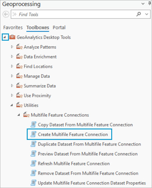

- Create a multifile feature connection (MFC) to analyze or visualize one or more Parquet files with the same schema. This method allows you to treat multiple Parquet files as a single dataset, which is particularly useful for analyzing large volumes of data. This option has been supported since the ArcGIS Pro 3.3 release as part of the GeoAnalytics Desktop toolbox.

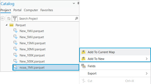

- Create a folder connection to the location where a Parquet file is stored. This can be from a local folder, network share, or an Amazon Simple Storage Service (S3) bucket. Then, add the file to the map to visualize, query, and analyze features. This is the new method added to ArcGIS Pro 3.5. The rest of this blog article will focus on this option.
The data is added as a new feature layer to the map. Behind the scenes, ArcGIS Pro creates a local cache of the data.

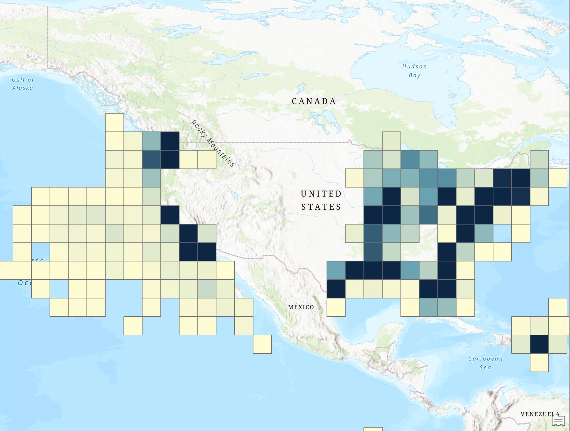

- Visualize data—Quickly add a Parquet file to a map or scene for immediate visualization with support for changing the symbology. For point datasets with more than 10,000 rows, the layer will draw as bins, allowing you to see patterns and trends in your data.

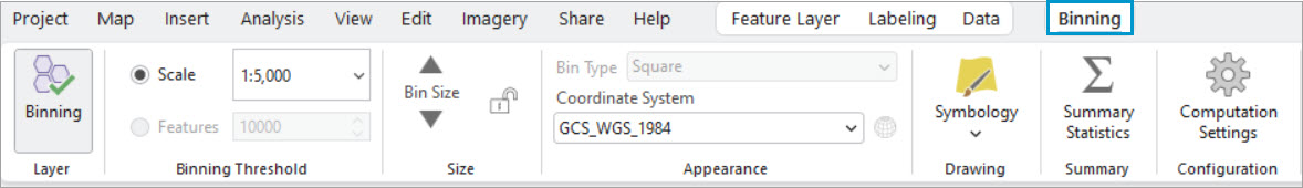

You can then use the Binning context menu on the ribbon to change some of its properties, such as the scale threshold or summary statistics, or you can completely disable binning.

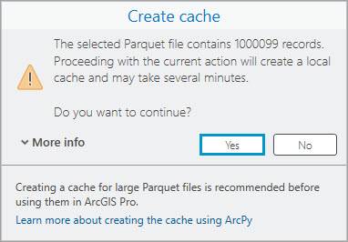

You can use the CreateParquetCache ArcPy function in Python to pre-generate the cache for a large Parquet file, which saves time by avoiding on-the-fly cache generation when adding data to a map in ArcGIS Pro. When a cache is generated for a Parquet file, subsequent additions of that file to a map by the same user will automatically tap into the cache, reducing loading time and enhancing data accessibility. To optimize Parquet file access, complete the following steps:
1.Store the Parquet file in a designated folder for data storage and processing.
2. To create Parquet cache, use the CreateParquetCache function in a script to automate the process of reading and creating caches for a Parquet file. This script can be run outside of ArcGIS Pro at any time, ensuring the cache is ready before accessing the Parquet file in ArcGIS Pro.
