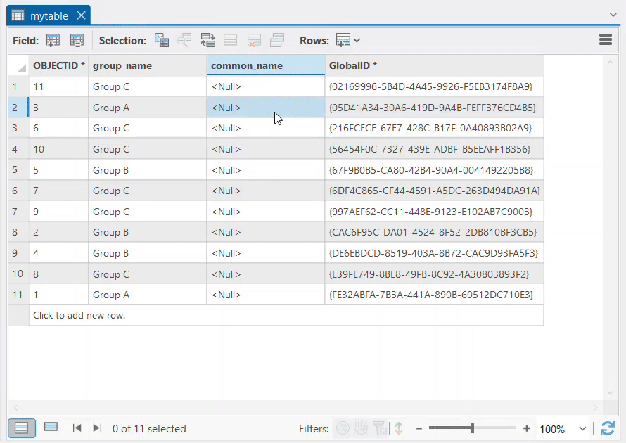

Consider this table, we have two fields: group_name and common_name. The common_name must match for all rows within the same group.

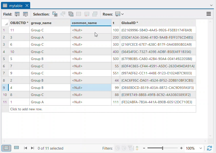

I will introduce a new field called “t” and populate it with random values. It is important to note that these values will remain unchanged; they will temporarily alter during editing and then be reset back to their original values.
And when we attempt to edit, you can see that the values update correctly without any errors, and the field we used to indicate attribute rule edits remains unchanged.
