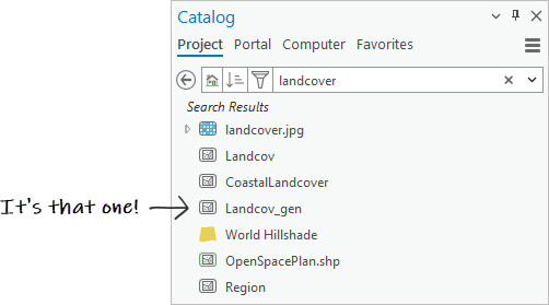

Where’s my landcover dataset? In this folder? Nope. I know it’s here somewhere. Did I move it over there? Guess not. Shoot. When situations like this come up–or whenever you need a better sense of the data available in your project–what do you do? Search!
The ArcGIS Pro index, working behind the scenes, is what makes searching for items possible. It keeps track of the contents of all your projects: maps, layouts, databases, folder connections (including subfolders and their contents), servers, styles, and other resources.

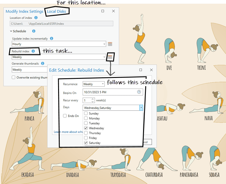

Each indexing task–incremental indexing, index rebuilding, and thumbnail generation–has its own schedule. When it comes to how often and when to run tasks, you can be as flexible as a yoga master. For example, you might rebuild your index daily or a couple of times a week, but only generate thumbnails once a month.
Schedules can also be different for local disks, network drives, enterprise geodatabases, and additional locations you designate for indexing.

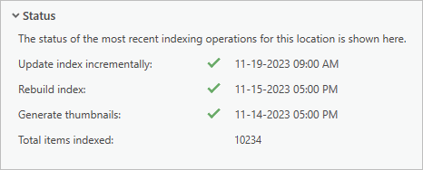

On the Modify Index Settings dialog box, expand the Status section at the bottom to see when the last indexing tasks were performed for that location. A green check mark means the task ran successfully. Other messages appear if a task is in progress or was cancelled for some reason.

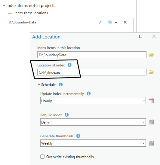

Before version 3.2, items weren’t indexed unless they were added to a project through a folder connection or some other connection. Now you can designate a folder to be indexed without adding it to a project. Items stored in the folder are returned when you search any project. This is a good way to make sure important data is always available and easy to find no matter what you’re working on.
By default, the content of a designated folder is indexed in your default resource index. You also have the option to make a new index specific to that folder in a different location. Either way, the folder has its own indexing schedule.
