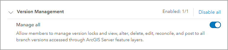

For portals that are using ArcGIS Enterprise 10.8.1 and later, a Manage all portal privilege is available to allow users to perform version management tasks. This is helpful if you have a portal user that needs to perform version management tasks, but does not need to have administrative level privileges in the portal.

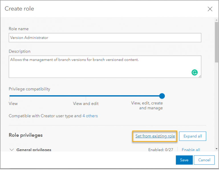

You might be wondering how exactly do I use this privilege? The Manage All privilege is not included in most of the default roles (with the exception of Administrator), so to use it you will need to create a custom role. When creating a role for your organization, you can set the role privileges from an existing role as a baseline. This allows the role to inherit all the privileges from an existing default role and from here you can enable the Manage all privilege. The Manage All privilege is located under General privileges > Version Management. Note that you will need to ensure that the Privilege compatibility slider is set to View, edit, create and manage to enable the Version Management – Manage all privilege.
Learn more about how to create a custom role

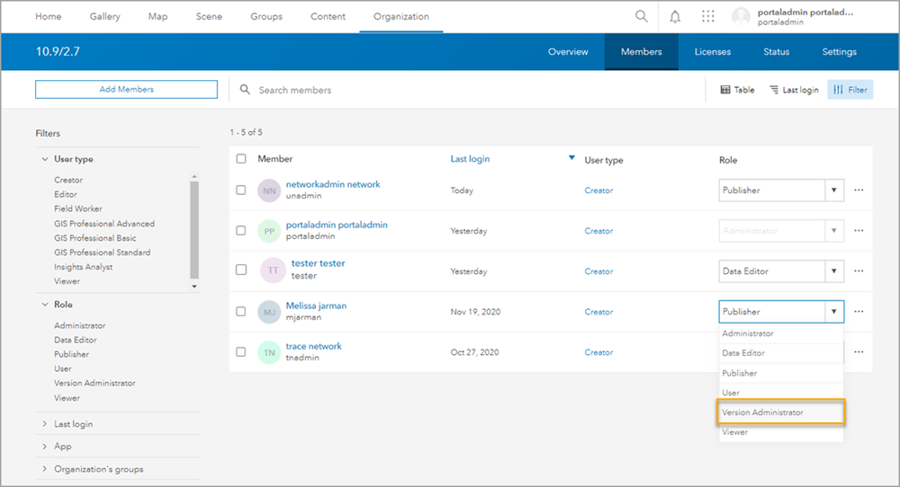

After the role is created, you’ll set this as the role for portal users that are going to serve as version administrators. This can be done under Organization and the Members tab by using the Role dropdown for the ArcGIS account to select the Version Administrator custom role.
Voila! Members with this custom role will have the ability to serve as the version administrator for services that they have access to in the portal.
