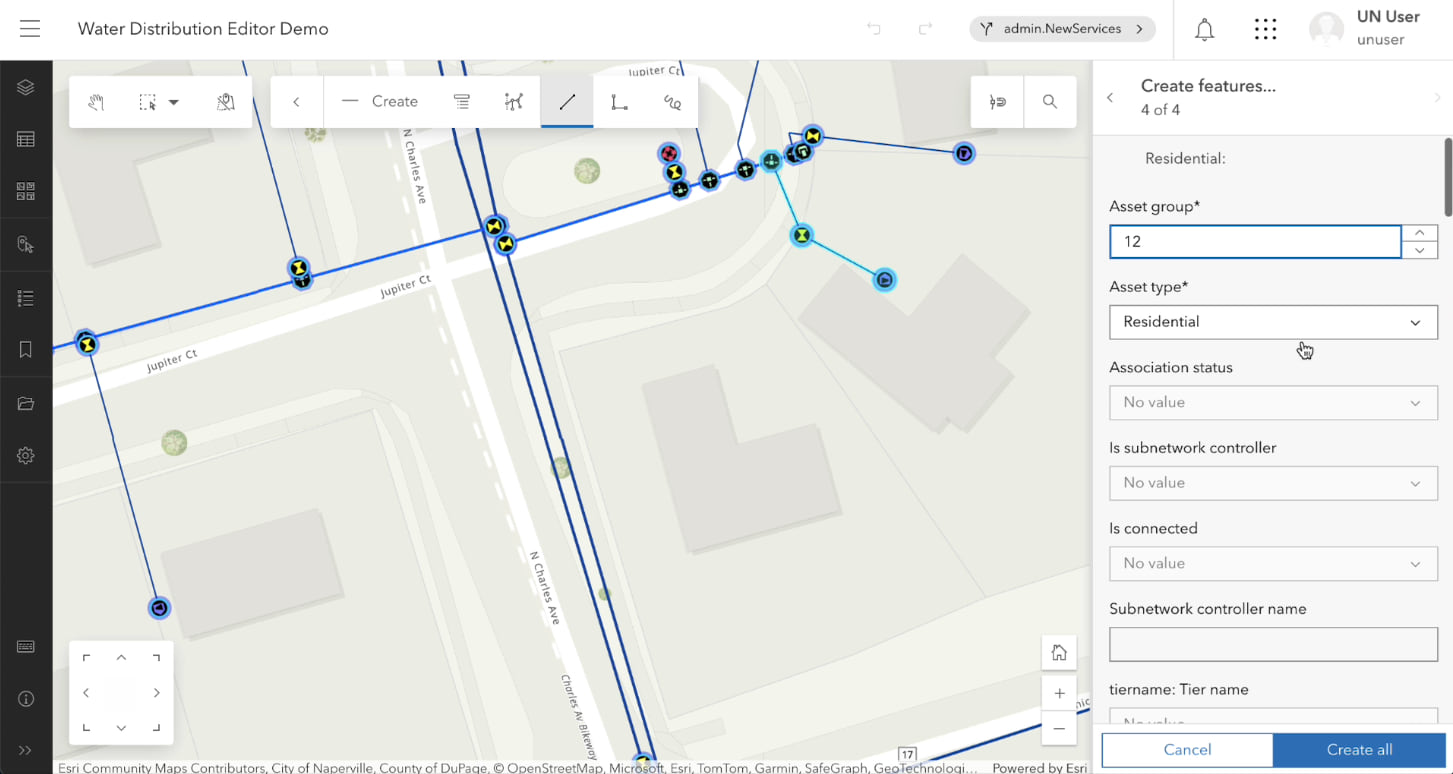

When using a group template in ArcGIS Web Editor to add a water service line and 3 devices along that line the results look like this:
The highlighted features on the map show the new water line and the devices added and the create pane on the right shows we are creating 4 new features as a result of using the group template.

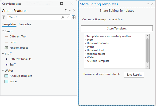

- Open the custom dock pane by activating the Add-In tab, then clicking the ‘Show Store Editing Templates Dockpane’ button.
- Ensure the correct map is activated by clicking on the map tab that contains the authored templates.
- Click on the ‘Store Templates’ button in the dock pane to store the templates to the geodatabase. The results are then written to the textbox in the dock pane, but can also be saved to file using the ‘Save Results’ button and browsing to a location to save a .txt file with the contents.
