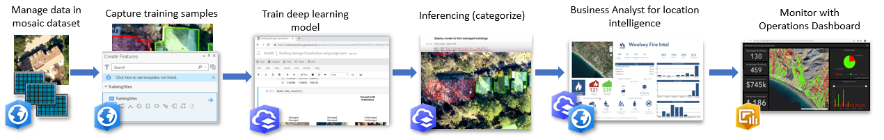

The process included capturing training samples, training the deep learning model, running inferencing tools and detecting damaged homes – all done within the ArcGIS platform. In this blog, we’ll walk through each step in the process.

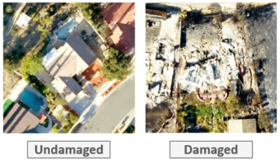

Prior to training a deep learning model, training samples must be created to represent areas of interest – in this case, the USAA was interested in damaged and undamaged buildings. The building footprint data provided by LA County, was overlaid on the high resolution drone imagery in ArcGIS Pro, and several hundred homes were manually labelled as Damaged or Undamaged (a new field called “ClassValue” in the building footprint feature class was attributed with this information). These training features were used to export training samples using the Export Training Data for Deep Learning tool in ArcGIS Pro, with the metadata output format set to ‘Labeled Tiles’.

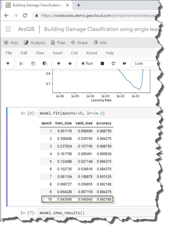

ArcGIS Notebooks was used for training purposes. ArcGIS Notebooks is pre-configured with the necessary deep learning libraries, so no extra setup was required. With a few lines of code, the training samples exported from ArcGIS Pro were augmented. Using the arcgis.learn module in the ArcGIS Python API, optimum training parameters for the damage assessment model were set, and the deep learning model was trained using a ResNet34 architecture to classify all buildings in the imagery as either damaged or undamaged.

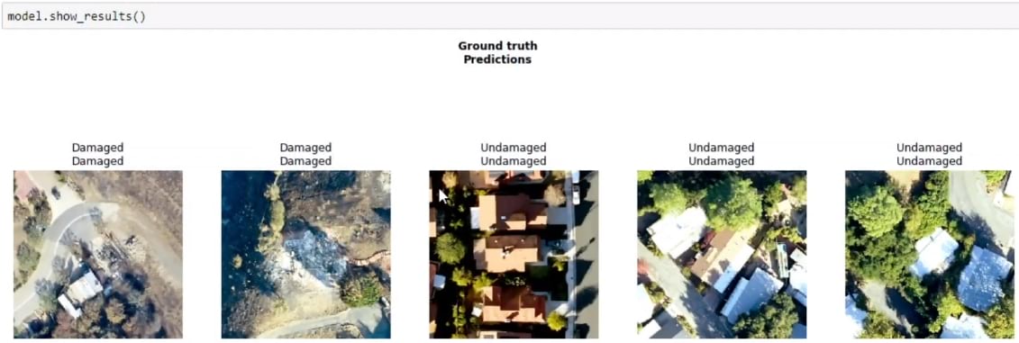

		Once complete, the ground truth labels were compared to the model classification results to get a quick qualitative idea on how well the model performed.
		For complete details on the training process see our post on Medium
Finally, with the model.save() function, the model can be saved and used for inferencing purposes.

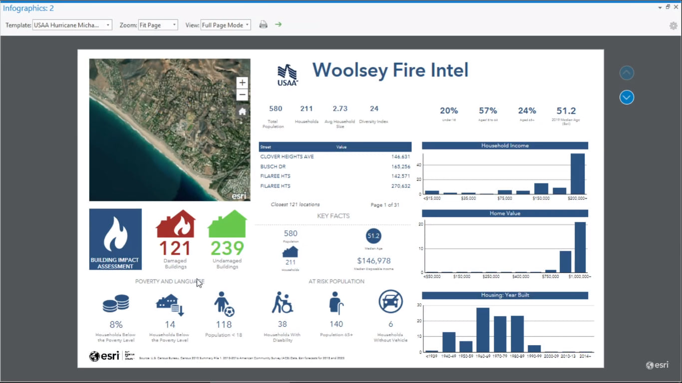

Business Analyst: Now that we had a better understanding of the impacted area, we wanted to understand who were the members impacted by the fires. When deploying mobile response units to disaster areas, it’s important to know where the most at-risk populations are located, for example, the elderly or children. Using Infographics from ArcGIS Business Analyst, we extracted valuable characteristics and information about the impacted community and generated a report to help mobile units make decisions faster.

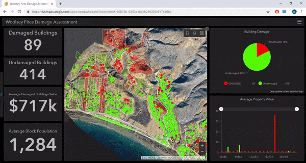

		Operations Dashboard: Using operations dashboard containing enriched feature layers, we created easy dynamic access to the status of any structure, the value of the damaged structures, the affected population and much more.
