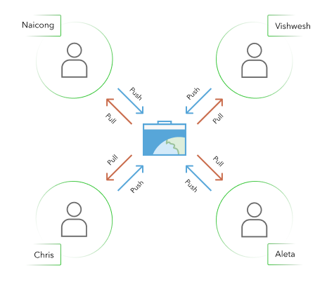

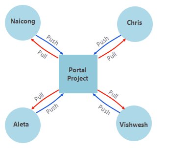

Consider an example where Chris, Aleta, Vishwesh, and Naicong are collaborating on a portal project. Each of them works independently in their own downloaded local copy.
When Aleta finishes some work on a map and saves the project before lunch, her changes are saved to her local copy and uploaded (pushed) to the portal. Once her upload is completed, any changes that have been pushed to the portal by others are downloaded (pulled) to her local copy.
And the same goes for everyone else?
Right. When Naicong saves the project an hour after Aleta, her changes are saved to her own local copy and then pushed to the portal. At that point, Aleta’s previous changes (along with changes that Chris or Vishwesh uploaded) are pulled down to Naicong’s local copy.
In this way, everybody’s local copy of the project is synced with the portal each time they save. Changes are pushed and pulled only when you save. So, for instance, if Aleta doesn’t work on the project for a week, she’ll pull a week’s worth of changes from the portal the next time she opens and saves the project.
Diagram of portal project collaborators
Each collaborator works independently in a local copy of the portal project, pushing and pulling changes when they save their work.

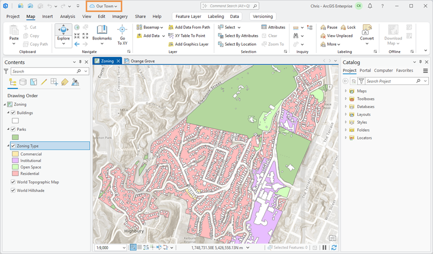

Local copy of an ArcGIS Pro portal project
Your local copy of a portal project looks like any other ArcGIS Pro project. The cloud icon by the project name identifies it as a portal project.

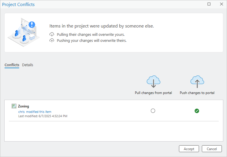

What if my colleague’s changes collide with mine?
Hopefully that doesn’t happen too often. (If it does, you should have a chat with your colleagues.) When it does happen, there’s a procedure for resolving conflicts.
Suppose Chris is working in a portal project called Our Town. He adds a Parks layer to the Zoning map. He also tweaks the legend in the Orange Grove layout. When he saves his local copy of the project, his changes are pushed to the portal. No conflicts at this point. The Zoning map on the portal (technically, the .json file that defines the Zoning map) now contains the Parks layer. Likewise, the Orange Grove layout has his modified legend.
Meanwhile, Vishwesh is working in his local copy of the project. His Zoning map doesn’t have the Parks layer. Suppose he changes the basemap of the Zoning map from Topographic to Imagery. That’s all he does. Now, when he saves the project, he has a conflict. Why? Because Chris just changed this map on the portal and now Vishwesh is changing it again. It’s kind of like two generals giving a soldier different orders. Vishwesh has a choice:
  • He can push his change to the portal. That will wipe out the Parks layer Chris added.
  • He can pull Chris’s change from the portal. That will add the Parks layer to Vishwesh’s local copy but wipe out his basemap change.
Project Conflicts dialog box
In this example, there’s only one conflict. If multiple items are in conflict, you can push all your changes, pull all changes made by others, or push some and pull others.
Let’s say Vishwesh decides to push his change. When he closes the Project Conflicts dialog box, the change is saved to his local copy and uploaded to the portal. The Zoning map on the portal now uses the Imagery basemap but doesn’t include the Parks layer.
Chris’s change to the Orange Grove layout, on the other hand, stays on the portal because it didn’t conflict with Vishwesh’s work. (Vishwesh didn’t touch the layout.) That means that the layout change is pulled from the portal to Vishwesh’s local copy of the project.
Why does adding a layer conflict with a basemap change?
Conflicts are detected and resolved at the level of the project item: that is, at the level of the map, layout, report, or presentation. So when Chris and Vishwesh both change the Zoning map—even though their changes seem compatible—it causes a conflict.
Only one user’s representation of the Zoning map (or any other project item) can exist on the portal. It can either be Chris’s, with the Parks layer and the original Topographic basemap, or Vishwesh’s, with the Imagery basemap but no Parks layer.
During conflict resolution, Vishwesh can’t see Chris’s changes and doesn’t know what they are. All he knows is that Chris made changes to the Zoning map and uploaded them to the portal before him.

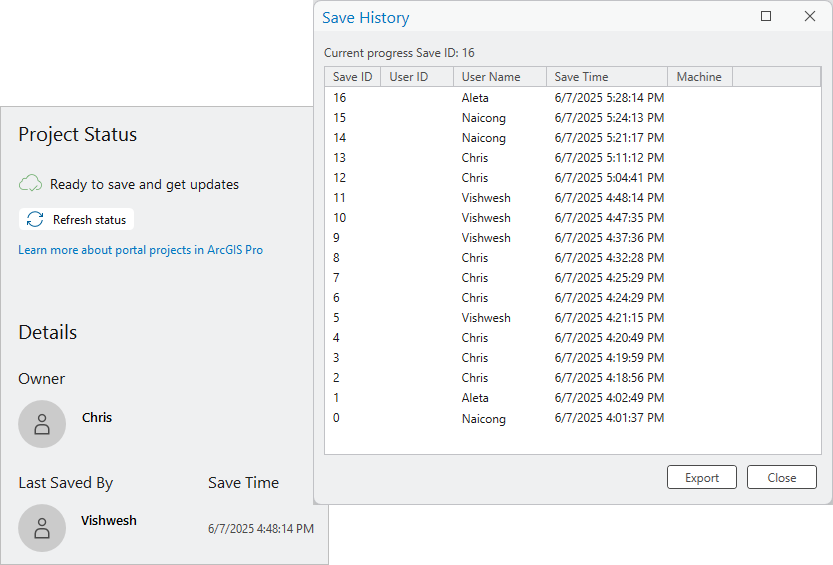

What if my colleague and I save the project at the same time?
That can’t actually happen. Someone is always first, even if it’s just by a little. When Aleta, for example, saves the project, the project is locked until her upload and download are complete. Other people can keep working in their local copies of the project, and save their changes locally, but no one can upload to the portal until her save is finished. Normally, the wait is just a matter of seconds, but it may be longer if Aleta is in the process of resolving conflicts—conflict resolution is part of the save operation.
Optionally, before you save, you can check whether the project is currently locked (and if so, by whom) on the Info page in the ArcGIS Pro settings. The Info page also shows you who owns the project and who saved it last. You can even access the project’s complete save history.
Project status and Save History on Info page
User IDs and machine names have been removed from the Save History dialog box.
More information about the project, like its sharing properties and delete protection status, is available on the portal. This is the same information you can get for any portal item.

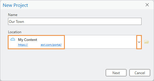

So how do I create a portal project?
The first part is like creating any new project, except that the project location is My Content on your ArcGIS Enterprise portal.
New Project dialog box with project location set to My Content
Use the drop-down arrow to set the location to My Content.

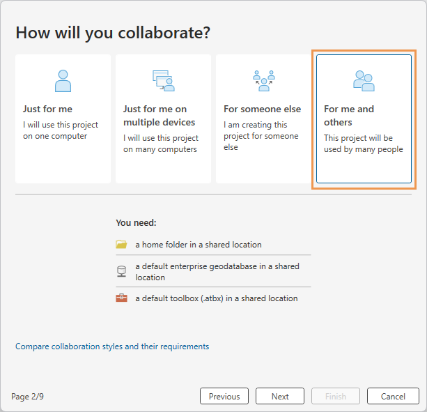

After you name the project, there are additional steps to complete. A wizard guides you through the configuration. (When you’re familiar with the process, you can turn the wizard off and use a dialog box instead.)
The first step is to choose a collaboration style. Not all portal projects are collaborative. You can create one for your own personal use on multiple computers, or for personal use on a single computer. You might do this, for instance, to give other people in your organization view access to the project even though you’re the only one working on it.
The collaboration style you choose affects your next settings.

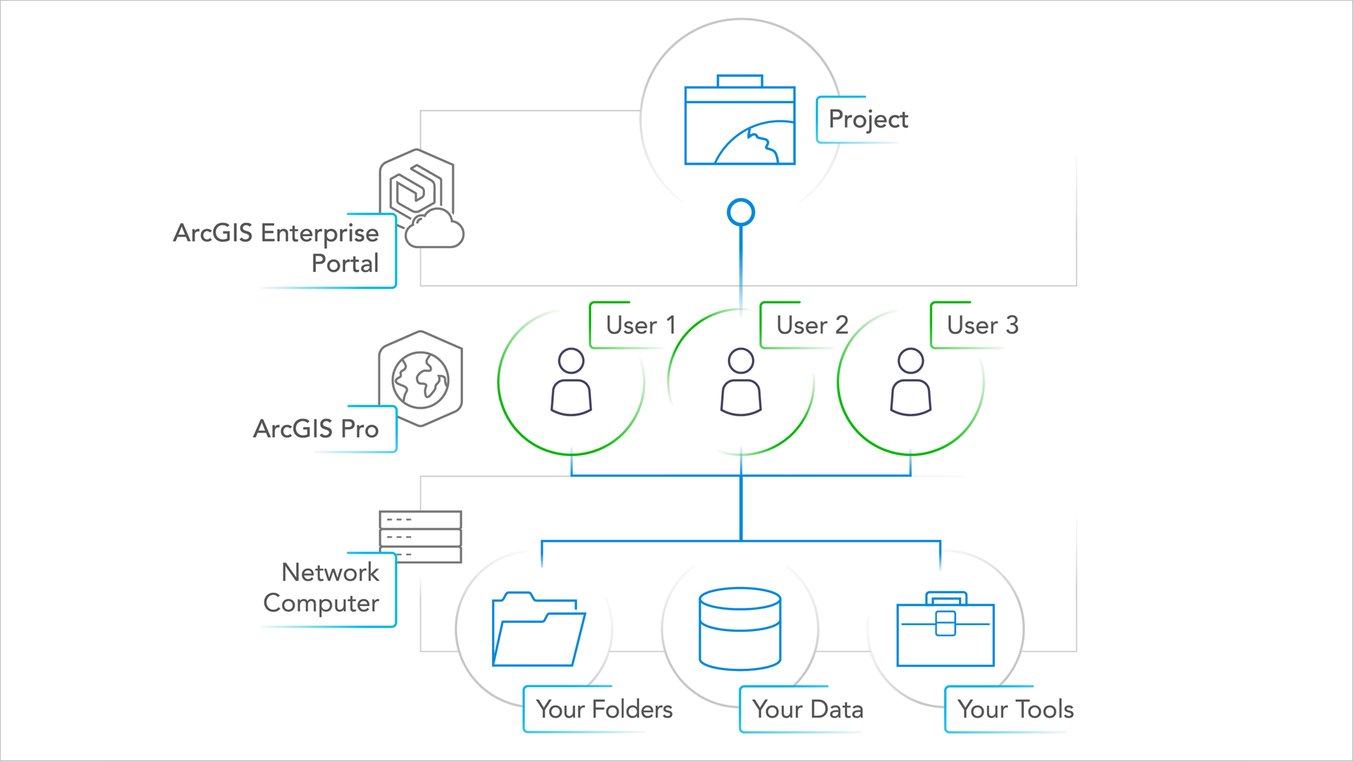

In a new local project, a file geodatabase and toolbox are created automatically by default. In a portal project, however, you either create these items yourself or browse to existing ones you want to use. This is where the collaboration style is relevant. If the project is for your own use, the default geodatabase can be a file or mobile geodatabase. In a collaborative project, it has to be an enterprise geodatabase to support multiuser workflows.
Similarly, in a collaborative project—or one for your own use on multiple computers—the home folder, default geodatabase, and default toolbox need to be located on a network share.
Whether you create the project using the wizard or the dialog box, ArcGIS Pro validates your settings to make sure they’re appropriate for the collaboration style.
Portal project wizard panel
When you choose a collaboration style, the default item requirements are specified.
