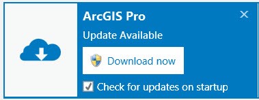

If you have already installed ArcGIS Pro and kept the default option to be notified when an update is available, you will see a notification appear when you start ArcGIS Pro (you must be signed in to ArcGIS Online to see the update notification). You can click Download Now to start the software update process or close the message box to dismiss the notification.

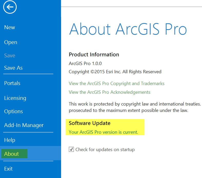

If you had unchecked the box to have ArcGIS Pro check for updates on startup, or if you happen to be in the middle of a session and want to check if software updates are available, you can click the Project tab and click About. If updates are available, you can run the update process (in the image below, no software updates are waiting to be installed).
