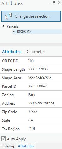

In my opinion, one big advantage ArcGIS Pro has over ArcMap is that you are always in edit mode. No more starting and stopping an edit session! This means if you see something that needs to be updated, you can make the change immediately. This also means that the Attributes pane is always available. - The Attributes pane
The Attributes pane displays feature attributes much like the Identify window in ArcMap. However, instead of requiring interactive clicking and dragging in the view, the Attributes pane works directly with the selection set. The attributes list can be changed by unselecting or selecting features in the map or attribute table. These selected attributes can be edited without the hassle of starting an edit session and then selecting the features you were just identifying as you had to in ArcMap. - Pop-ups
