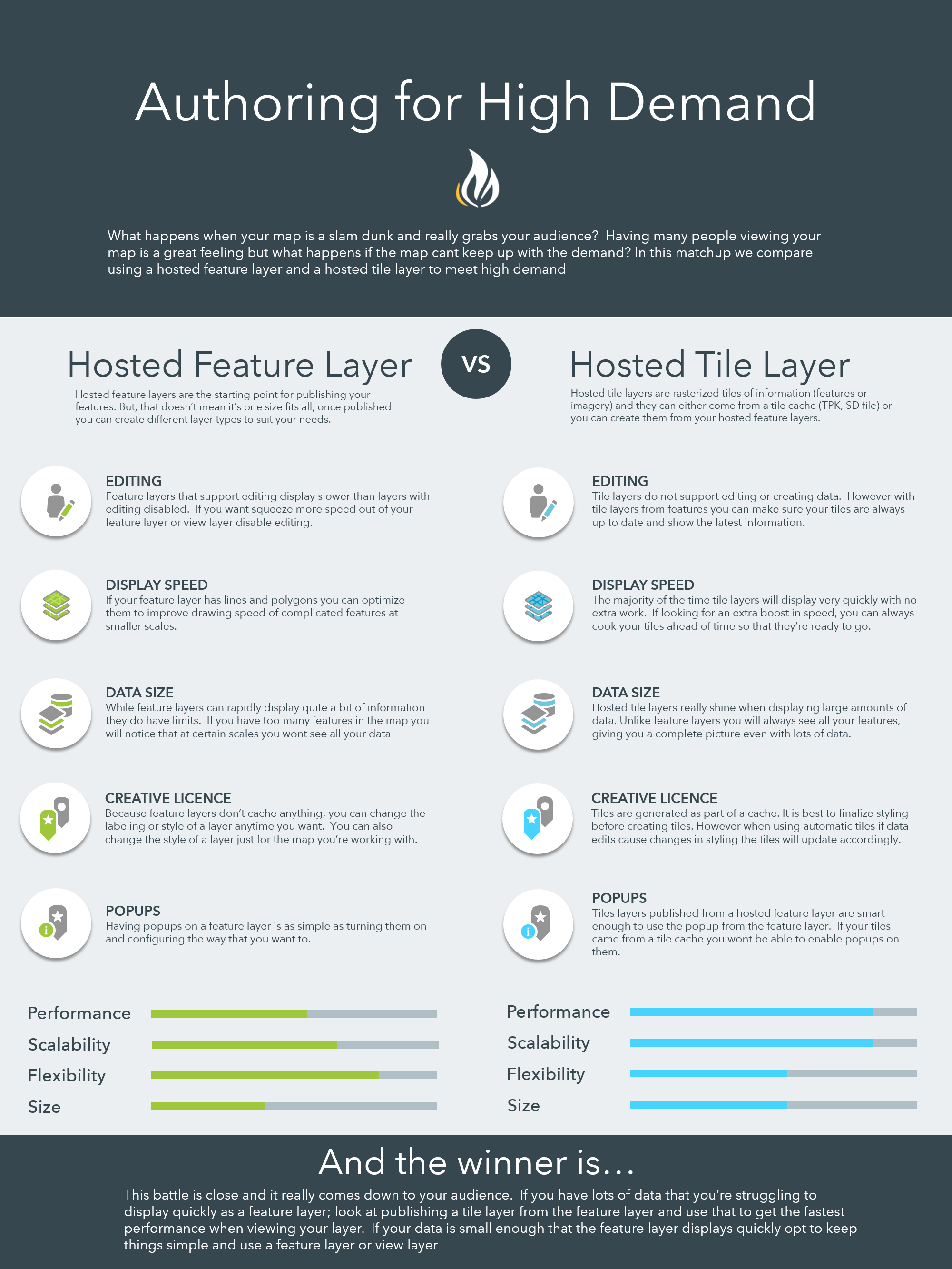

Round 1 – Authoring for High Demand

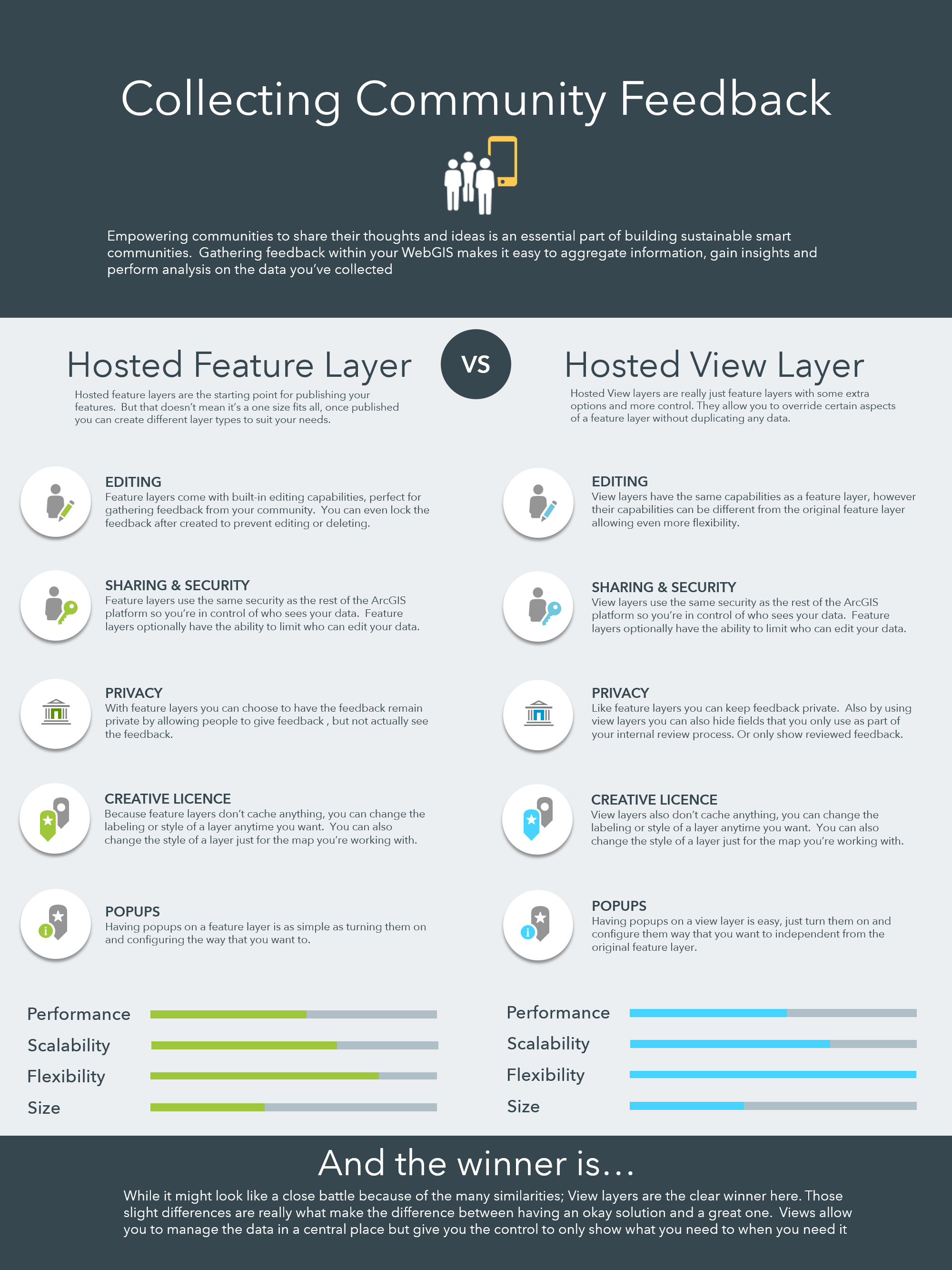

Round 2 – Collecting Community Feedback

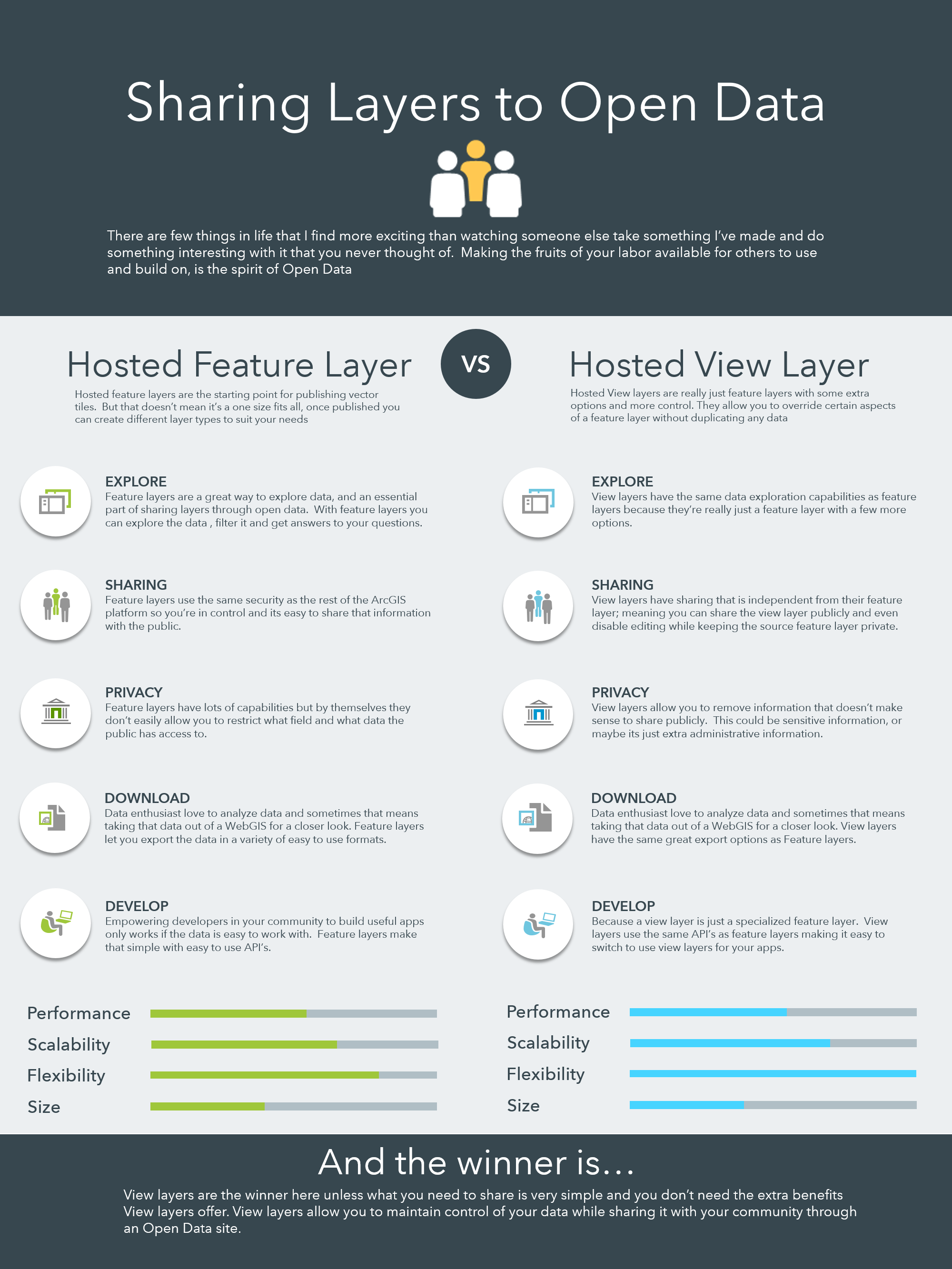

Round 3 – Sharing layers to Open Data

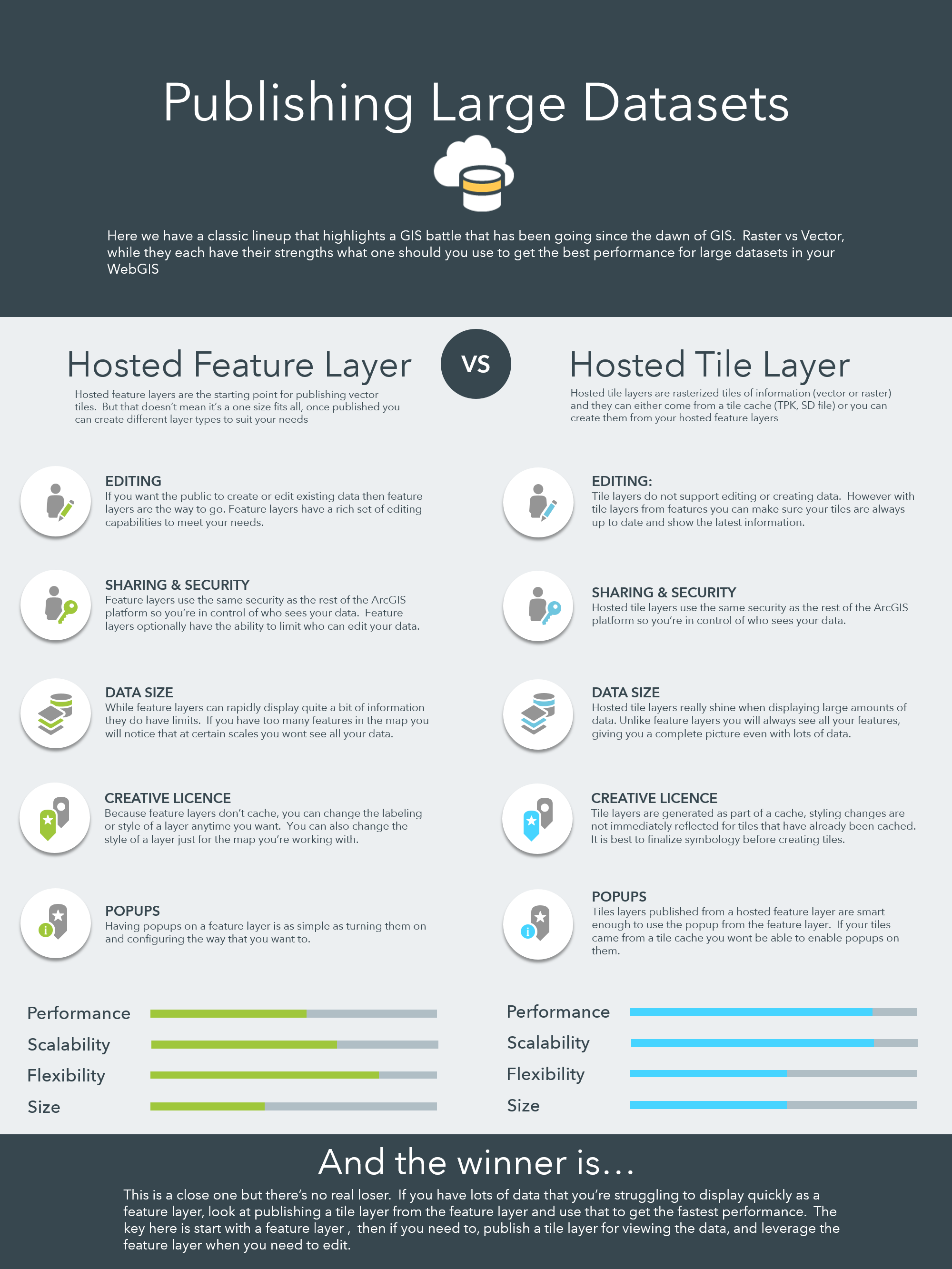

Round 4 – Publishing Large Datasets
