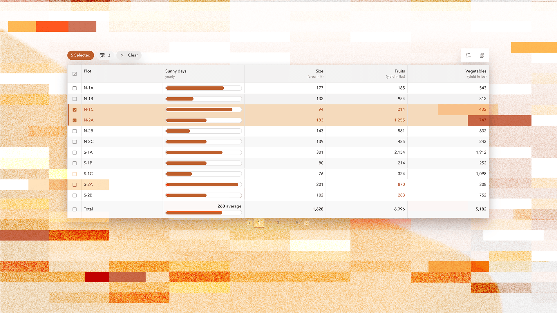

Table
The new Table and related components Table Header, Table Row, and Table Cell provide an effective way of organizing your data or content on your page into rows and columns.
Table is simple and flexible; for example you can construct it with or without headers, make the rows selectable, and limit the number of rows shown per page which automatically enables pagination. You can also embed other components within Table Cells, as shown below.
Table is selectable and numbered, and contains a column header and footer. It also embeds the Meter component within Table Cells.
