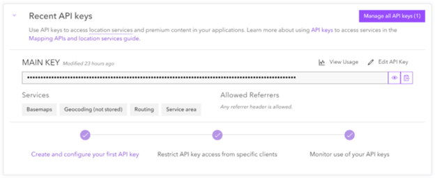

- Access token: Create an API key that is scoped to access the geocoding service.

2. Go to ArcGIS developer dashboard to get an API key. Ensure it is scoped (Geocoding (not stored)) to access the geocoding service.

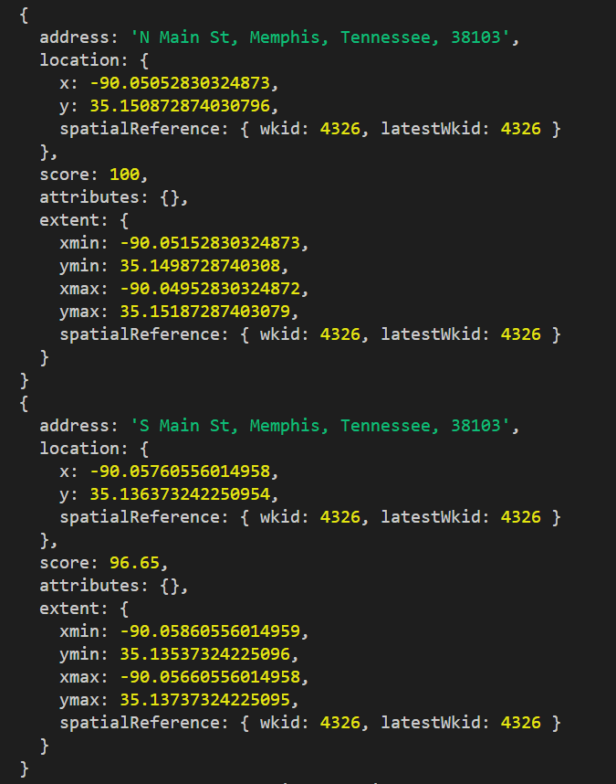

Run the application
Run the application in the terminal window. The results should resemble the example below:
The results include the address candidates that were found by the geocoding service. Each candidate contains the following:
- location: The x (longitude) and y (latitude) values in decimal degrees and the spatial reference.
- score: The accuracy of the match used for verification purposes. 100 represents a perfect match and values less than 100 represent a decreasing accuracy score.
- attributes: The default values returned or the values specified by the outFields parameter.
Other values are returned such as the extent and spatial reference.
