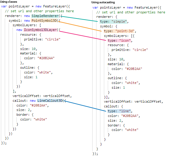

Let’s look at an example where we set a renderer with a 3D symbol, labels, and callouts on a FeatureLayer:
To achieve this prior to 4.5 we needed to import six modules for the renderer, symbol, symbol layer, label symbol, text symbol layer, and the callout. The full list of required module imports looks like this:
require([ "esri/WebScene", "esri/views/SceneView", "esri/layers/FeatureLayer", "esri/renderers/SimpleRenderer", "esri/symbols/PointSymbol3D", "esri/symbols/IconSymbol3DLayer", "esri/symbols/LabelSymbol3D", "esri/symbols/TextSymbol3DLayer", "esri/symbols/callouts/LineCallout3D", "dojo/domReady!" ], function( WebScene, SceneView, FeatureLayer, SimpleRenderer, PointSymbol3D, IconSymbol3DLayer, LabelSymbol3D, TextSymbol3DLayer, LineCallout3D ){ // use modules here });
With this new workflow, you don’t need to import modules for the renderers and the symbols. So in the example above, you only need to import the WebScene, SceneView and FeatureLayer:
require([ "esri/WebScene", "esri/views/SceneView", "esri/layers/FeatureLayer", "dojo/domReady!" ], function( WebScene, SceneView, FeatureLayer ){ // use modules here });
But how do we actually define the renderer and symbol objects without the required modules? We do this by specifying their type in a JavaScript object, just like in the example below:
If you want to play with the examples yourself, here’s the code snippet for using classes and here’s the code snippet for using types. These snippets were derived from the Point styles for cities sample in the documentation.

For many properties, you don’t need to specify the type of object to autocast since the API already knows the expected type. For example, you don’t need to set a type property in an object representing SimpleMarkerSymbol.outline because the expected type for the outline of a simple marker (and all other symbols) is SimpleLineSymbol.
However, renderer, symbol, symbol layer, and geometry objects are usually passed as values to polymorphic properties, meaning the API doesn’t know how to autocast the object unless the type is explicitly specified. The snippet below demonstrates both scenarios in context:
layer.renderer = {
// type must be specified since
// 1 of 3 renderer types could be applied here
type: "simple",
symbol: {
// the type must also be specified for symbol properties of a renderer
// since 1 of 10 symbol types could be used
type: "simple-marker",
outline: {
// Specifying type for outlines is not necessary
// since `simple-line` is the only expected type
style: "dash-dot",
color: [ 255, 128, 45 ]
So how do you know the value of the type property for any given scenario? There are number of ways to find the required type value. You can…
- Find the type in the documentation,
- Use the Symbol Playground to configure the code and copy the autocastable snippet for immediate use in your app, or
- Infer the value.
Generally, you can infer the type by removing the generic text from the desired class name and kebabifying it. For example, SimpleFillSymbol.type is simple-fill (note that symbol is removed because it is used in all related 2D symbol class names). Another example: UniqueValueRenderer.type is unique-value (there’s no need to specify renderer in the type). IconSymbol3DLayer.type is icon (the Symbol3DLayer bit is common among all symbol layers). See the comprehensive tables below to more fully understand this pattern. Once you’re familiar with it, you won’t have to look it up in the documentation!
