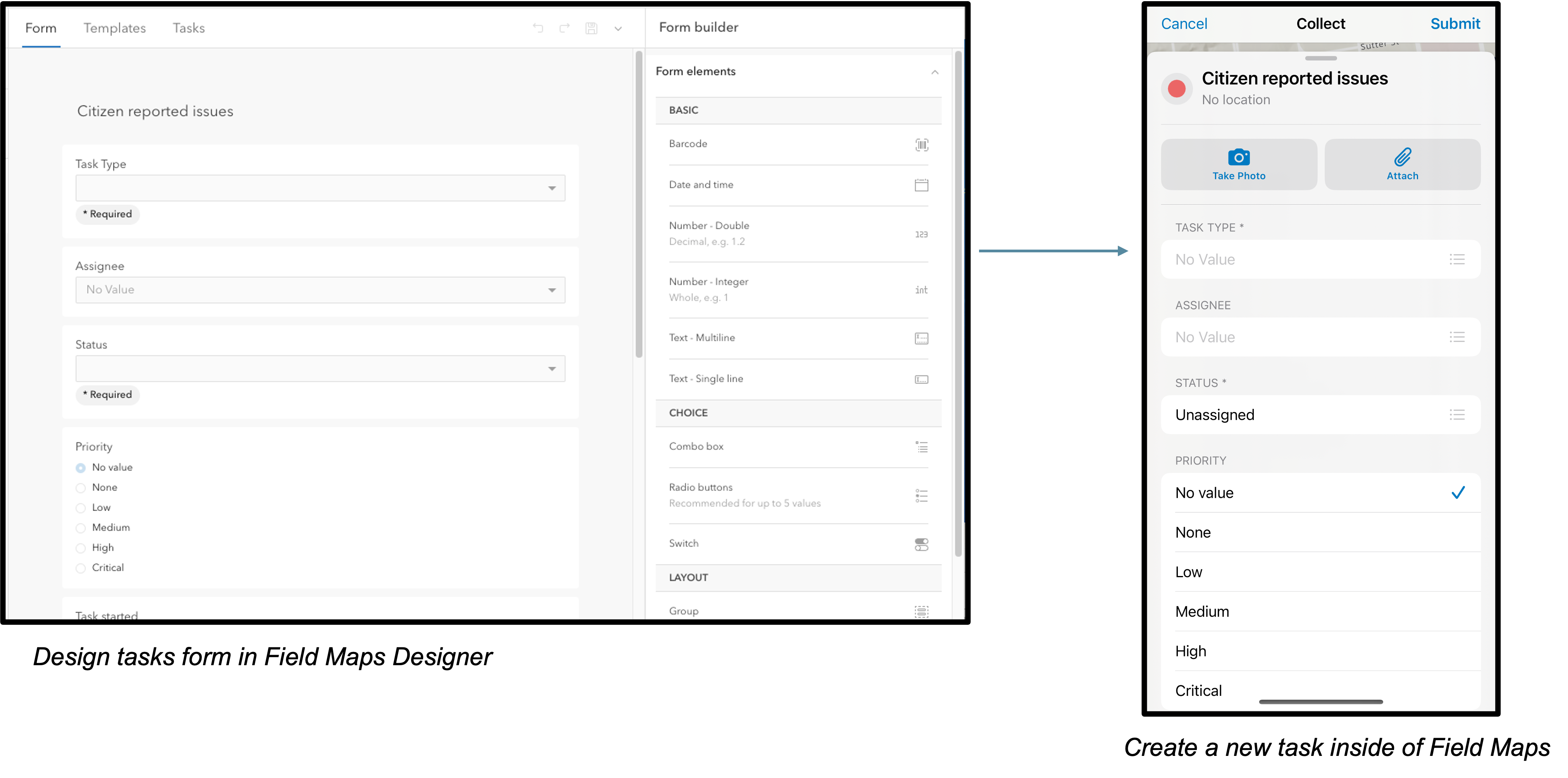

Tasks forms are fully customizable, allowing you to tailor the layout, fields, and logic to match your team’s workflows, from simple checklists to complex data collection scenarios. This is the form that task creators fill out when defining a new task, making it essential for capturing the right context, instructions, and requirements to guide field execution effectively.
Screenshots of building the task form in Field maps Designer and viewing the task form in Field Maps mobile app

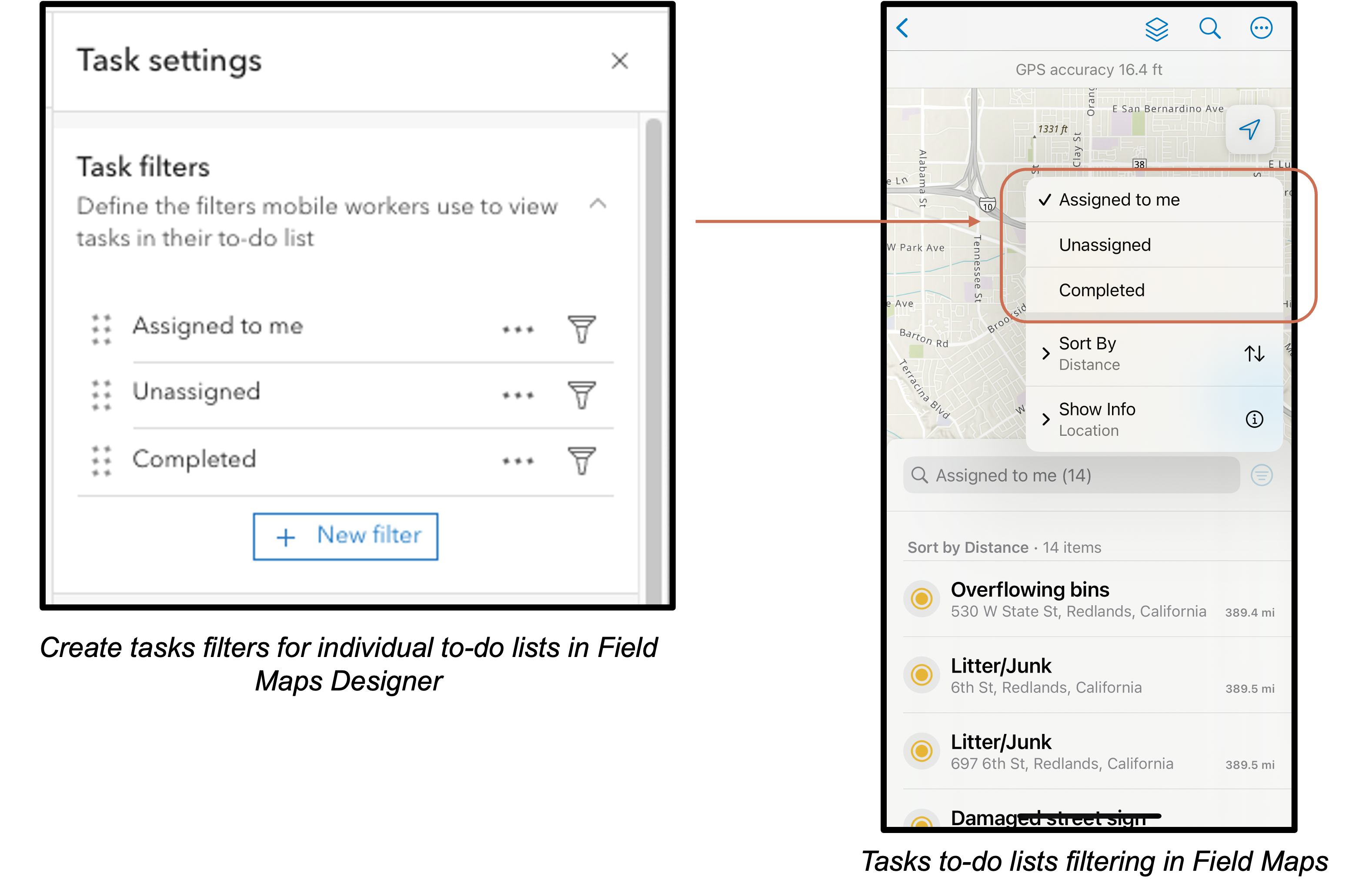

Task filters define the dynamic to-do lists that mobile workers see in the Field Maps mobile app. By default, filters are provided for tasks that are “Assigned to me”, “Unassigned”, and “Completed”. You can use these, customize them, or create your own.
Each task filter is powered by an expression that evaluates task attributes to determine which tasks appear in the list. For example, the default “Assigned to me” task filter looks at the current logged in user to pull any tasks that are assigned to that user and not in a completed state to compile the to-do list.
Task filters in Field Maps Designer and how they show up in Field Maps mobile.
