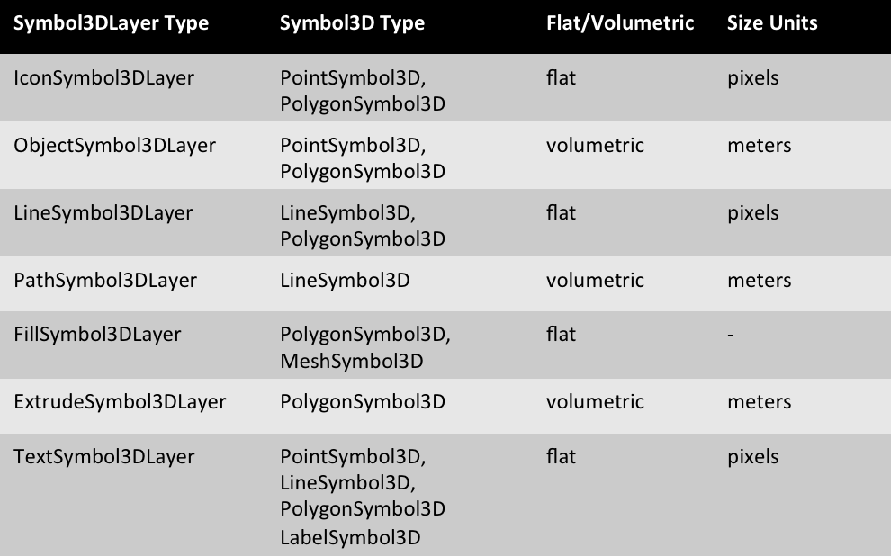

The following table summarizes each symbol layer type and which 3D symbols they may be applied to.

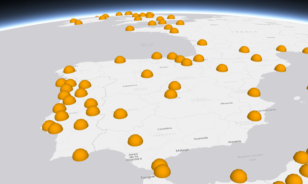

In the following sample, we use a sphere primitive in an ObjectSymbol3DLayer to symbolize world cities. Notice the size is set to a value of 50,000 (m).
var renderer = new SimpleRenderer({ symbol: new PointSymbol3D({ symbolLayers: [new ObjectSymbol3DLayer({ resource: { primitive: "sphere" }, material: { color: "orange" }, width: 50000 })] }) });

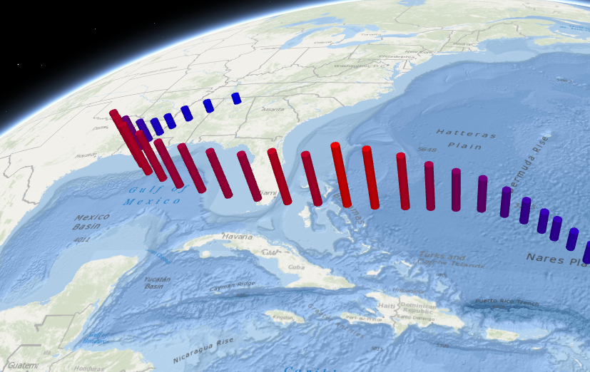

But working with 3D objects can be more complex. Objects like cylinders and pyramids have three axes to consider: height, width (diameter from east to west), and depth (diameter from north to south). The axis property on the size visual variable allows us to define each of these values. In the hurricane sample below, we set a constant size on the width and depth axes to make all cylinder diameters the same size (50km). The height axis is used to set the height of each feature between 60km and 450km based on the value of the WIND_KTS field.
var renderer = new SimpleRenderer({ symbol: new PointSymbol3D({ symbolLayers: [ new ObjectSymbol3DLayer({ resource: { primitive: "cone" }, width: 50000 // width of the symol in meters }) ] }), visualVariables: [{ type: "color", field: "PRESSURE", stops: [ { value: 950, color: "red" }, { value: 1020, color: "blue" } ] }, { type: "size", field: "WINDSPEED", stops: [ { value: 20, size: 60000 }, { value: 150, size: 500000 } ], axis: "height" }, { type: "size", axis: "width-and-depth", useSymbolValue: true // uses the width value defined in the symbol layer (50,000) }] });

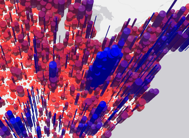

Because we have three axes to work with, we can visualize two or more variables with size. In the following sample two attributes are mapped with size on different axes: height (and color) indicates the percentage of the population affiliated with the Democratic party and width indicates the percentage of people who self-identify as conservative.
var renderer = new SimpleRenderer({ symbol: new PointSymbol3D({ symbolLayers: [new ObjectSymbol3DLayer({ resource: { primitive: "cylinder" } })] }), visualVariables: [ { type: "size", field: "MP06024a_B", // Affiliated with Democratic Party normalizationField: "TOTPOP_CY", axis: "height", valueUnit: "unknown", stops: [ { value: 0.15, size: 10000 }, { value: 0.25, size: 2000000 } ] }, { type: "size", field: "CONSERVATIVE", // Identify as conservative normalizationField: "TOTPOP_CY", axis: "width-and-depth", valueUnit: "unknown", stops: [ { value: 0.21, size: 10000 }, { value: 0.26, size: 100000 } ] }, { type: "color", field: "MP06024a_B", // Affiliated with Democratic Party normalizationField: "TOTPOP_CY", stops: [ { value: 0.15, color: "#FF3030" }, { value: 0.20, color: "blue" } ] } ] });
CLICK HERE TO VIEW THE LIVE SAMPLE
In this sample we’re looking at two variables: the percentage of the population that are democrats and the percentage of the population that are conservative. Based on the way the visual variables are defined, we would expect areas with a high percentage of democrats to have tall, deep blue, skinny cylinders since conservatives tend to favor the Republican party. That certainly appears to be the case in areas like San Francisco and New York. Interestingly, we see a few pockets of low population areas where there appears to be a higher percentage of conservatives and democrats. We shouldn’t assume that most people in these areas identify as conservative democrats, but looking at the numbers (via the popup) in each of these counties, it is reasonable to conclude there are a fair number of people who could identify as such.
