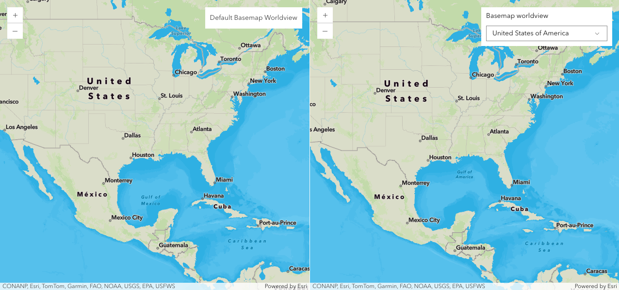

Here is a sample app showing how you can set the worldview parameter to get the basemap with a particular worldview.

Use the basemap styles service, specify the style you want, and set the worldview parameter of Esri Leaflet Vector to change the political worldview of the basemap layer.
See the Change the basemap worldview sample.
