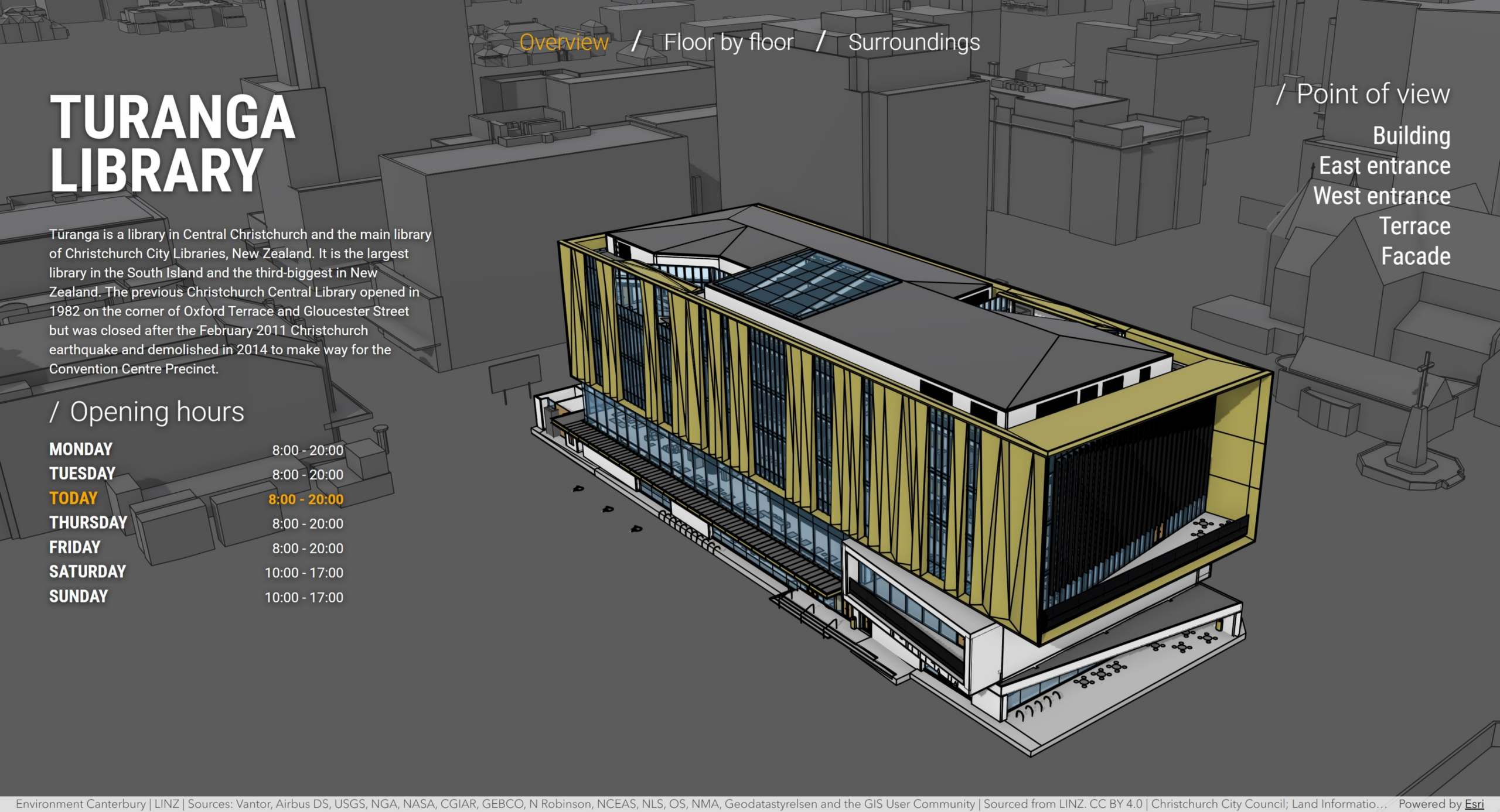

To show how large migrations work in practice, we migrated the Building Viewer showcase by capturing its requirement and recreating the application from scratch. You can explore the new version here: Building Viewer and compare it with the original version here: building-viewer/version-4.
Building Viewer App
Building Viewer Showcase
