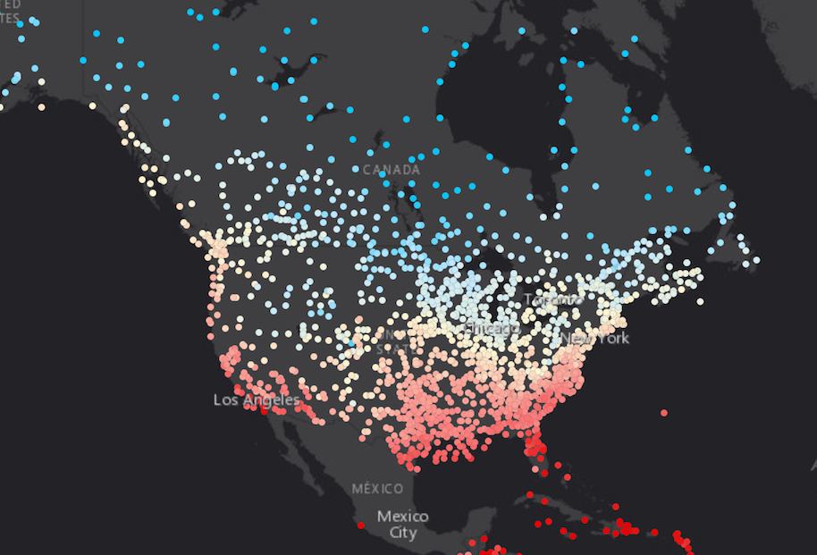

I’ll use the following sample to demonstrate how to use Arcade in a data-driven visualization within a custom app built with version 4.2 of the JavaScript API. This sample visualizes the apparent temperature (the estimated temperature people actually feel depending on factors such as wind chill and humidity) measured at weather stations worldwide. In the sample, I use Arcade to calculate wind chill and the heat index based on wind speed, air temperature, and relative humidity numbers provided as attributes in the service. The expression then determines which variable (heat index or wind chill) to use as the apparent temperature.
Once written, the expression is set on the valueExpression property of the renderer or visual variable used for the visualization.
Using Arcade eliminates the need to add new fields to a service layer and perform a series of field calculations to return these same results.

This expression will execute for each feature in the layer within the context of the renderer and return the apparent temperature for each given point. In the renderer’s color visual variable, we map specific temperatures to colors for visualization purposes.

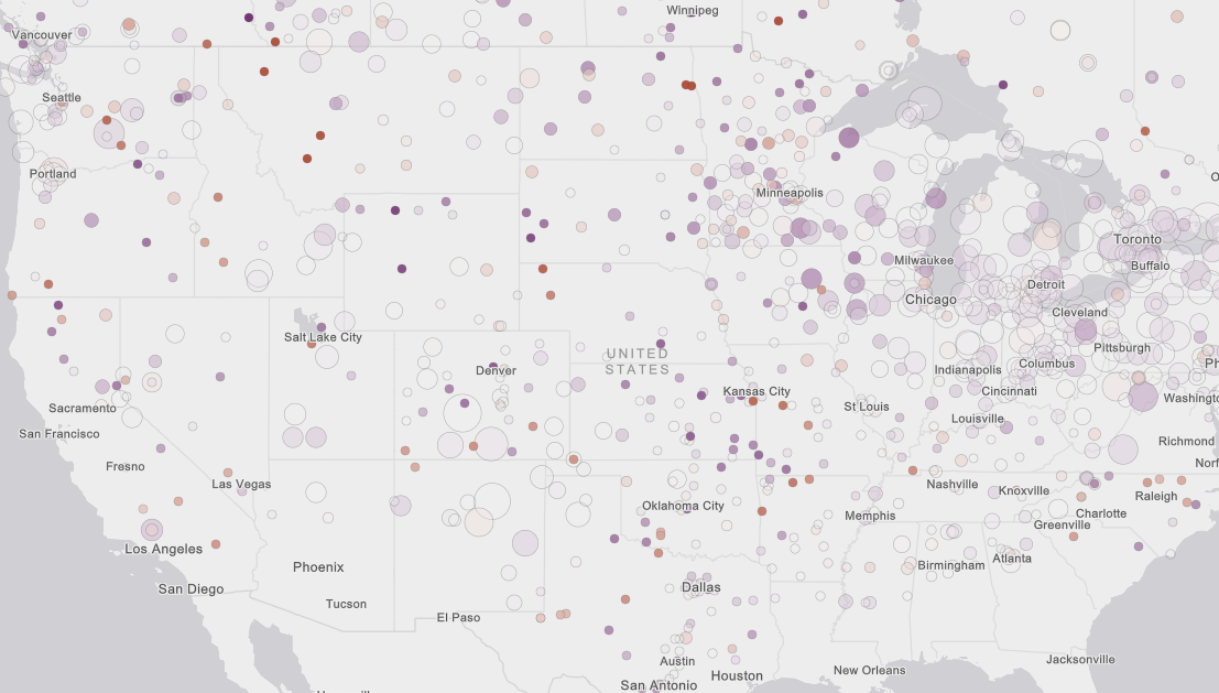

Rather than use a web map, you can alternately save the visualization directly to the layer within the map viewer, or by using the Visualization tab in ArcGIS Online. In the example below, I created a bivariate visualization using two Arcade expressions. Color is driven by the apparent temperature expression and size is driven by the difference between apparent temperature and the measured air temperature.
