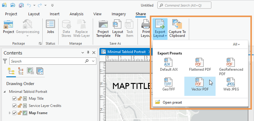

Export presets wouldn’t be very helpful if you had to navigate to the preset file every time would they? That would be just as annoying as setting all the options by hand. To avoid constant navigation ArcGIS Pro has a gallery of export presets.
To access the gallery click the bottom of the Export button on the Share tab in the ribbon. You’ll see a list of export presets you can choose from. Clicking on one of the presets opens the export pane with the preset configuration loaded. All you need to do is set the export name (not saved with the file, since usually file names are unique) and click the big export button at the bottom of the pane. It’s easy; 1,2,3 Export!
Since maps and layouts have different export properties, presets exist for both. It’s the same file extension, but the information is a little different. So you can’t use a map preset when exporting a layout or vice versa. In the gallery you’ll only see the export presets applicable to the kind of export (map or layout) you are currently doing.
Picture of the ArcGIS Pro interface showing the export gallery for layout exports. 6 different export presets are visible.

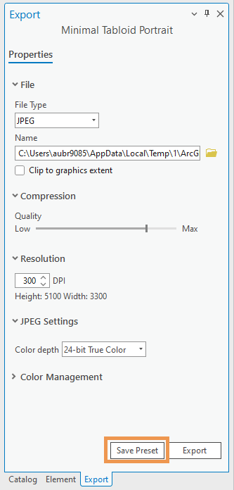

ArcGIS Pro includes 9 default presets (6 for layouts, 3 for maps) with general recommended settings,  but you’ll probably want to build some of your own. To do that, just open the export pane for a map or layout and choose your settings.  The click the Save Preset button at the bottom of the pane. Give the preset a name, and even choose a location to save it to. The default location will add the preset to the export gallery. If you save it to a different location it won’t be added to the gallery (unless you change the gallery path, learn about that here).  That’s it!
It’s worth mentioning again that the file name and location is not saved in the preset. Additionally, for PDF exports the security, map series, and accessibility options are not included in a preset because they often needed to be configured for each export.
The export pane for a layout in ArcGIS Pro. The Save Preset button at the bottom of the pane is highlighted.
