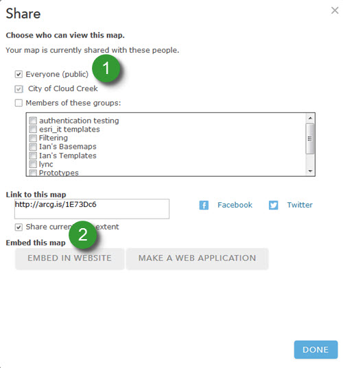

In order to embed a map in a website it must be shared with Everyone. From the Map Viewer click the Share button, then:
- Share the map with everyone.
- Click Embed In Website.

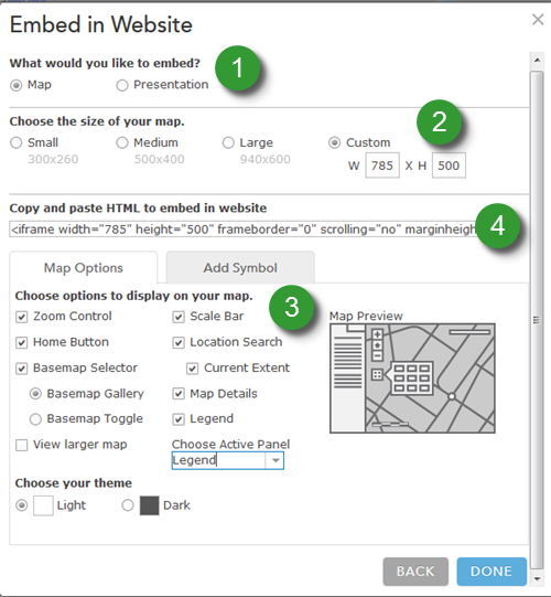

The embed app is highly configurable through the Embed in Website dialog window. Follow this simple 4-step process:
- Choose what you want to embed. This post is concerned with maps, but you could also embed a presentation.
- Choose the size of your map in pixels.
- Choose the map options you want included. The Map Preview will give an idea of what your options will look like in the final product.
- Copy the code for embedding the map in your website then click Done. The HTML can then be incorporated into your website.
