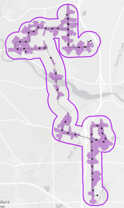

Service Areas vs. line buffer
Line buffers drastically overestimate the area served by a transit line.
To find the area served by your transit system, the first thing you might be tempted to do is to create a quarter-mile buffer around the transit lines. Please don’t do that! People can’t just jump on or off the bus or train as it rolls along. They have to use the designated stops. If you buffer around the lines, you will drastically overestimate the area served.
The next thing you might be tempted to do is to create circular buffers of a quarter mile or so around your transit stops.  Although this is a little better than line buffers, it’s still not great.  After all, people usually can’t walk in a straight line in every direction from the transit stop.  They are constrained, for the most part, to walk along the streets or sidewalks.  If you have to zig-zag through a warren of streets, your quarter mile will be expended before you reach a quarter mile as the crow files.  You might also run into geographic or man-made features in the way, like a river or highway with no pedestrian crossing.  So, circular buffers around stops can also drastically overestimate the area within a short walk of each stop, and, in turn, the area served by your transit system as a whole.
Service Area vs. circular buffer
Circular buffers overestimate the area reachable within a travel time or distance from a point if the traveler is constrained to a road network.
The solution is to use the Service Area tool. Service Areas, also known as isochrones or drive time polygons (or walk distance polygons, in our case) show the area reachable from a given location within a time or distance limit, assuming the traveler is constrained to a road network and subject to certain rules, like speed limits, oneways, or roads closed to pedestrians. If you calculate a Service Areas around each transit stop in your system, you will achieve a much more accurate estimate of the area served by your transit system.

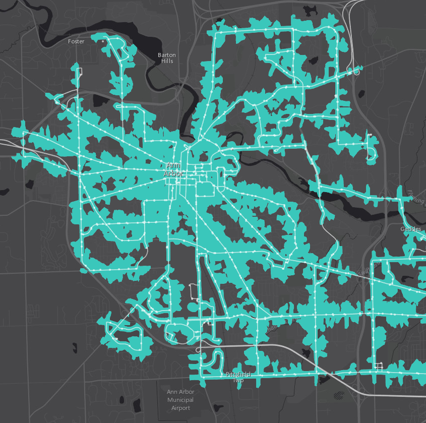

The image above shows a comparison of a quarter-mile circular buffer and network-constrained Service Area for a bus stop in Ann Arbor, MI. The image below shows Service Areas for all the stops in Ann Arbor. You can click either image to explore an interactive map.
Transit system coverage in Ann Arbor, MI
Transit system coverage in Ann Arbor, MI, calculated using the Service Area tool

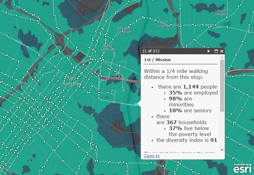

Once you have calculated the coverage of your transit system, you can do some demographic analysis to find out more about the people served by the transit system. The Enrich Layer tool in ArcGIS Pro or ArcGIS Online makes this particularly easy. You can choose from hundreds of demographic variables from Esri’s extensive demographic content, and the tool will summarize this demographic information for whatever polygons you feed it (like your transit system’s Service Area).
Actually, if the only thing you’re interested in is the demographics of the populations within a walk distance of each stop, and you don’t care about visualizing your transit system’s service area in a map, you can just enrich the stops directly without generating the polygons first. The Enrich Layer tool will calculate Service Areas on the fly if you choose “Walking time” or “Walking distance” in the “Define areas to enrich” parameter.
Demographic information summarized for transit stops in Los Angeles
Demographic information for transit stops in Los Angeles has been summarized using the Enrich Layer tool. Click the image to explore entire city in a web app.
