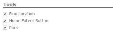

6. Add print to configurationPanel.js in the resources folder. This will add the configuration options so that app authors can enable or disable the print button in the configuration panel.
61    {
62       "category": "Tools",
63       "fields":[
64          {
65             "type": "boolean",
66             "fieldName": "locate",
67             "label": "Find Location"
68          },{
69             "type": "boolean",
70             "fieldName": "home",
71             "label": "Home Extent Button"
72          },{
73             "type": "boolean",
74             "fieldName": "print",
75             "label": "Print"
76          }
77       ]
78    }
a. See this help doc for information adding parameters to configurable templates.
b. The code above will produce the following section of the configuration panel:

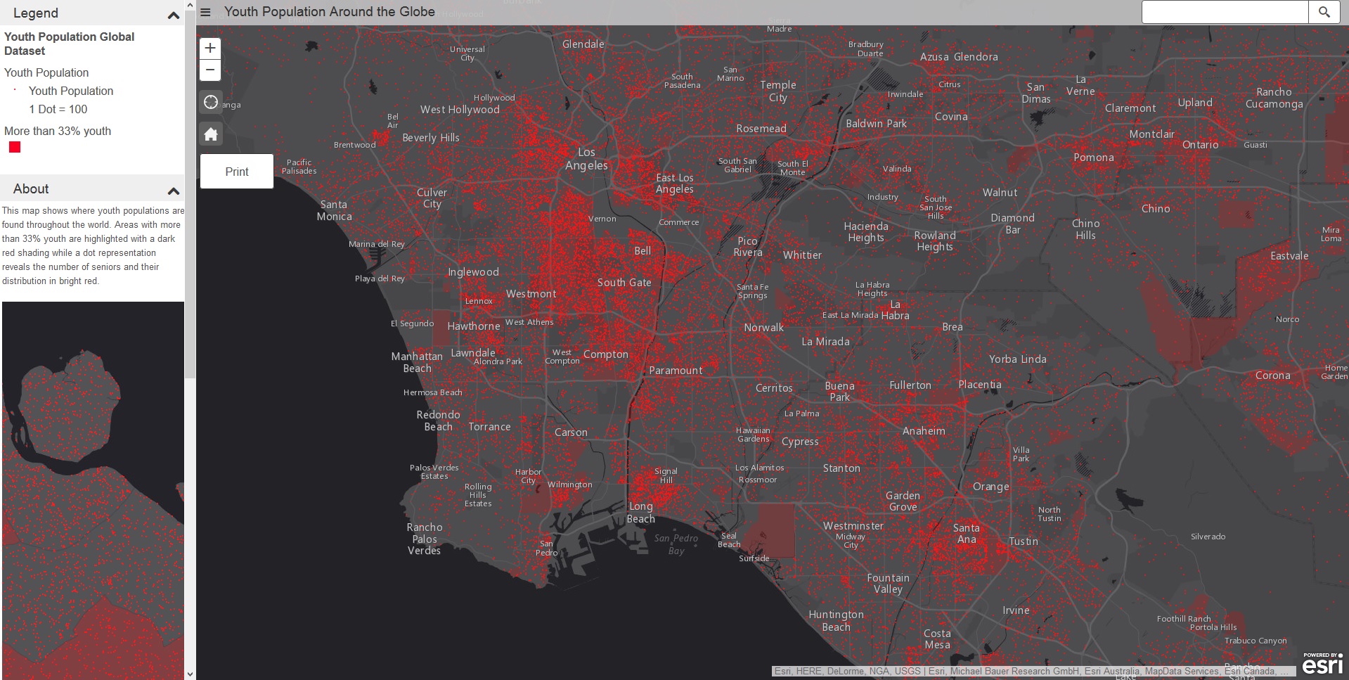

Here is what a map looks like with my version of the Simple Map Viewer:
Here is a link to the item details page where you can download the code: http://www.arcgis.com/home/item.html?id=6d41153556084d75a64dc8509dd4bd8e
