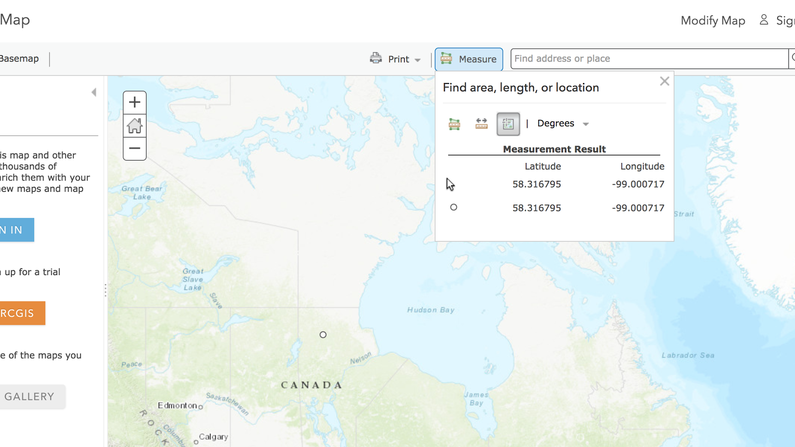

On a computer, open up a blank web map in ArcGIS Online in one window and a spreadsheet (I used Excel) in another window. On the webmap, have your interviewee locate points on the map that corresponded to segments of their oral history. The easiest way to do this is by clicking on the “Measure” tool on the top of the page, clicking on the third icon from the drop-down menu, and then clicking points on the map. This tool will generate the lat/long coordinate for each point your interviewee finds. Each point the interviewee selects on the map, copy the lat/long in the Excel document.

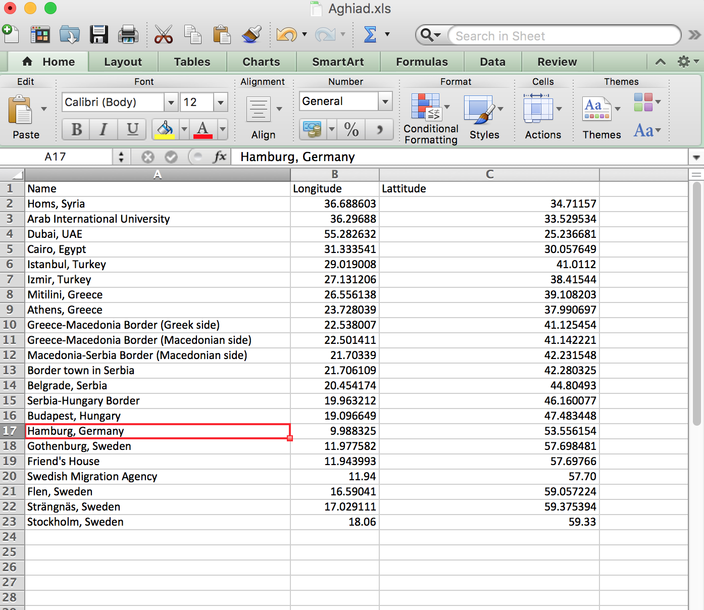

For your project, once you collect the lat/long coordinates for whatever story you are working on, make sure to separate the coordinates into two different columns in Excel, one called “Latitude” and one called “Longitude”. I included a “Name” column and added in a name for each point (e.g., “Damascus, Syria”). You can feel free to add and fill in any extra columns you see fit. Make sure that whatever you plan to include as a part of the spatial data, you add to the spreadsheet during this step. It it much more difficult to add things in later on.
After formatting the Excel sheet, save the spreadsheet as a .csv file on your local computer.

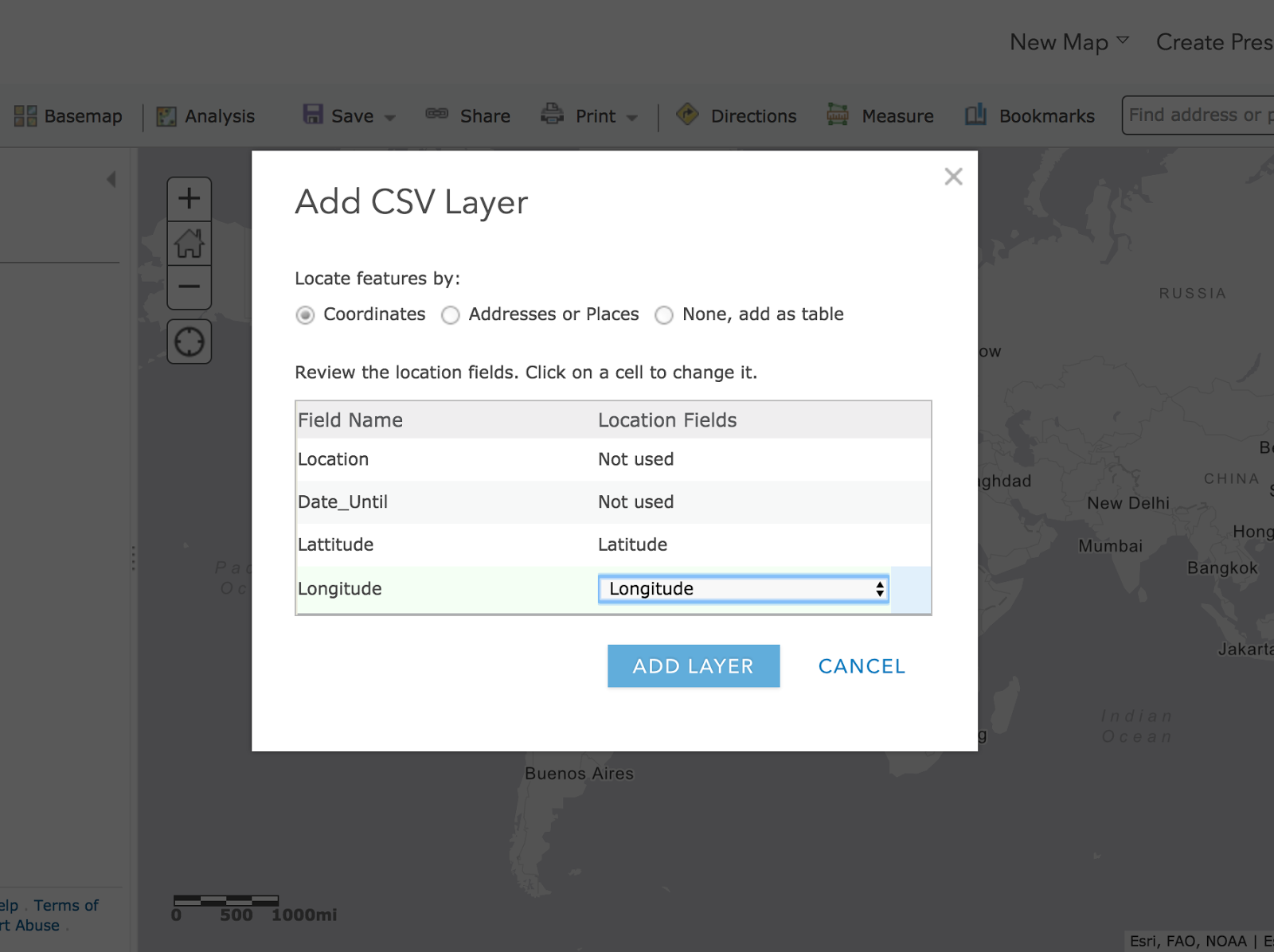

Now, you need to specify which fields in your spreadsheet are the lat/long coordinates. In the new window, make sure the “Locate features by” prompt is set to “Coordinates.” Below it, you will see a list of all the columns from your spreadsheet. Click the text that is directly to the right of “Latitude” (or whatever you named the latitude column), and you should see a dropdown list. Select “Latitude.” Do the same for “Longitude.” Click “Add Layer.”
And there you go! You should see dots on the map pop up, corresponding exactly to the points your interviewee located during your interview process. If the points look all over the place, it is likely that you mixed up lattitude and longitude when making your spreadsheet (this happened to me twice during my project). Simply repeat the steps above except switch “Latitude” and “Longitude” when designating the location columns in the CSV import dialogue.

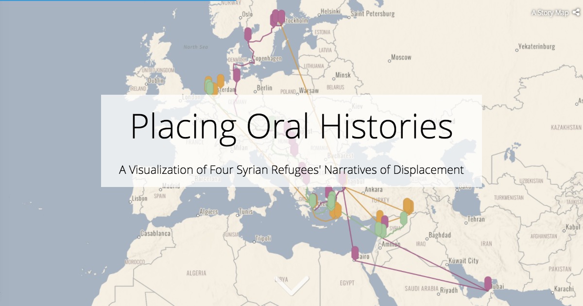

- Build a Story Map. Story Maps are a perfect way to blend together text, photos, maps, and even audio to create an archive of one’s oral history. Placing Oral Histories used the Story Maps Cascade Template, but the Story Maps Journal template also works very well with these kinds of projects. Check out this tutorial to get started.
