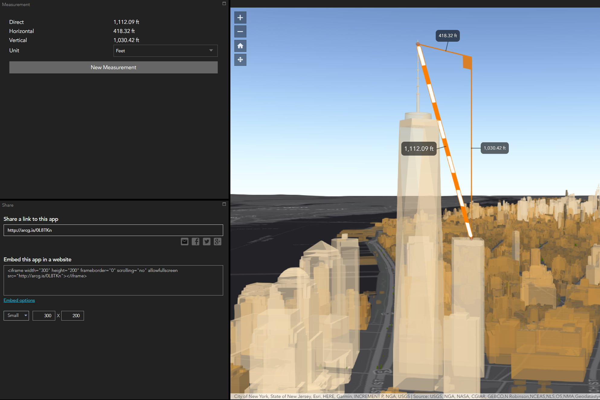

- Sharing - the Share widget is now available in 3D apps, and it allows you to share your app by posting it to your social media account, sending an email with a link, or embedding it into a website or blog.
- Measurement – one of my personal favorite widgets is available for your 3D apps. It can measure horizontal, vertical, and direct distance between two points.

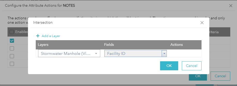

- Smart Editor widget has the capability to not only edit related records of editable layers, but you can also edit related records when the parent record is not editable. For instance, imagine you want the fire department to inspect and report issues with hydrants, but you do not want them to modify the hydrant itself. The feature service needs both the hydrant and inspection table because of the relationship, and it also needs to be editable. Support has also been added for attribute action, which allows you to define custom actions for the data.
Intersection Attribute Action - With the Edit widget, you can add a new record for a related feature layer. For example, let’s say you have a feature layer that has parcels, and within that layer, there is a relationship to buildings located on those parcels. In this scenario, you can edit those features and ensure the relationships are inherited.

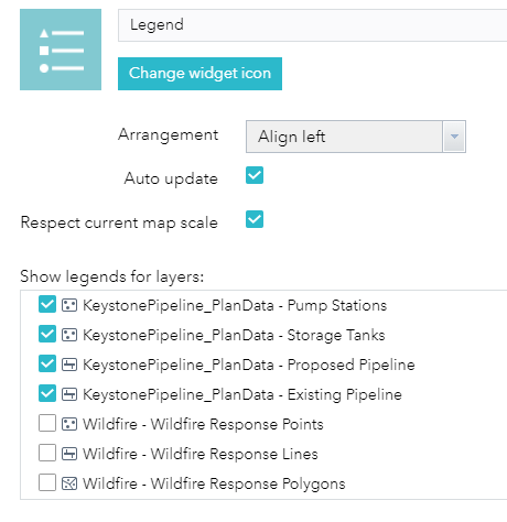

- Legend widget gives you full control to configure which layers you would like to display in the legend, regardless of what is listed in the Layer List widget. This a nice user interface (UI) enhancement.
Legend Widget - Share widget gives you the option to include the organization’s URL when sharing your application.
