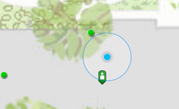

  • A more accurate location means that its margin of error is less. Your position might be identical, but if you know you have 10 meter accuracy, you know you are likely within 10 meters of the location shown. If you have 30 meter accuracy, you know you are likely within 30 meters of the position shown. In Workforce, the blue circle around your position indicates the accuracy. In the image below, Workforce believes you are between the tree and the other mobile worker (green pin). However, you might be closer to the green dot, or you might be with the other mobile worker. But it is pretty sure you are inside the bigger blue circle.
Worker location on the map
