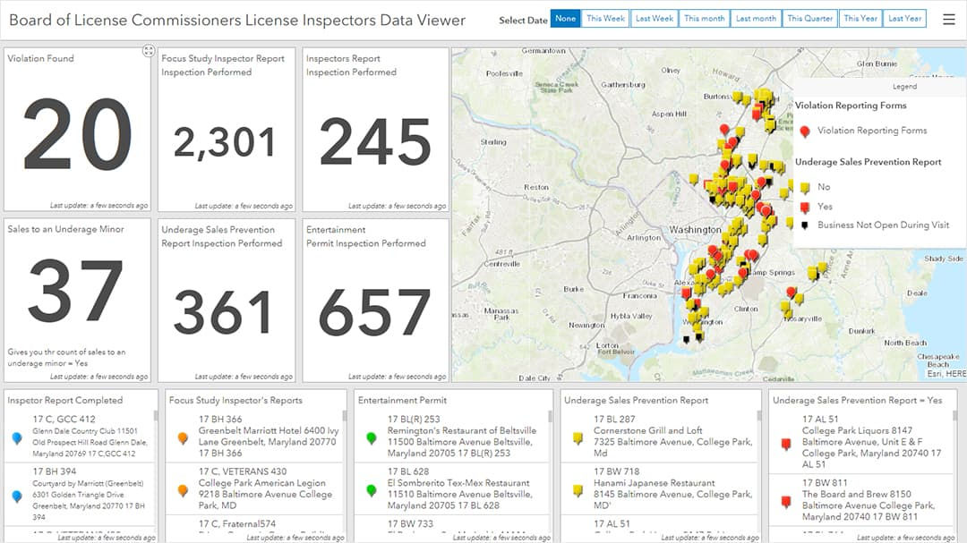

Back in the office, supervisors use Operations Dashboard for ArcGIS. The dashboard provides a real-time operational view of what inspectors are doing in the field and allows supervisors to monitor key performance indicators, such as the number and locations of completed inspections. BLC supervisors also use Operations Dashboard to generate weekly and monthly reports of all inspections.

With a revamped and modern inspection process based on ArcGIS, BLC is seeing significant cost and time savings. Surveys are loaded automatically into ArcGIS, eliminating the manual data entry workflow and backlog. It's no longer necessary to archive and store paper surveys—plus BLC now has a usable storeroom.
The inspection process is more efficient, too. Inspectors complete 65 percent more inspections a day and have cut in half the time needed to finalize a survey. All the maps and tools are encapsulated in one, lightweight device.
