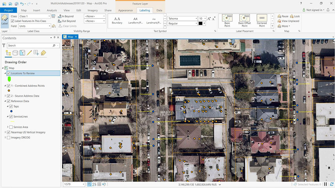

Tasked with developing the inventory, Denver Water's GIS team began with tap locations pulled from the utility's customer billing database. The team then added research results from hand-written records kept by one utility employee who had previously replaced many lead lines. Those records were augmented with information from construction permits issued by the City and County of Denver, including when the permit was issued and the type of work it covered.
GIS staff worked with a consultant to build the initial inventory using Esri ArcGIS Desktop. Denver Water staff migrated the lead data to ArcGIS Pro as they progressed with the project.
These combined sources of information resulted in fewer than 1,000 locations of lead service lines. With many historic homes in the Denver Water service area, the team had to analyze additional data sources to get a more accurate inventory depiction.
ArcGIS Pro was used to manage the inventory of lead service lines.

Corona Environmental Consulting helped build the inventory by updating the geodatabase with existing data, such as tap date and year the parcel's home or building was built. The consultants also added results of previous water quality tests at customer taps. The GIS team used the new data in ArcGIS Desktop to sort locations into categories, describing the certainty or likelihood of a lead service line.
The resultant data was added to an ArcGIS Pro project and developed into a lead service line inventory map used by decision-makers to plan line removals.

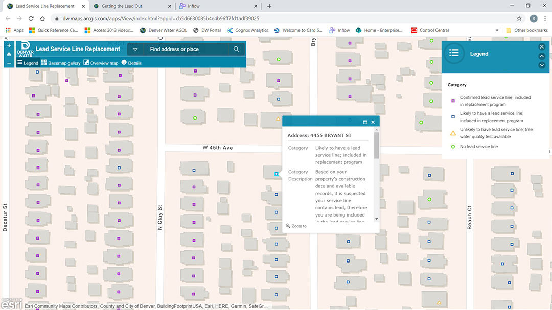

This public facing web map enables customers to find out if they are included in the program and what their service line is categorized as.

Once identified, addresses in Denver and the suburban areas were added to the inventory, and a public-facing web map was developed in ArcGIS Online using ArcGIS Web AppBuilder. This map informs customers whether they are included in the program and whether their service line is categorized as known lead, likely lead, unlikely lead, or nonlead. The team also created an ArcGIS StoryMaps story to teach website visitors how to use the map.
