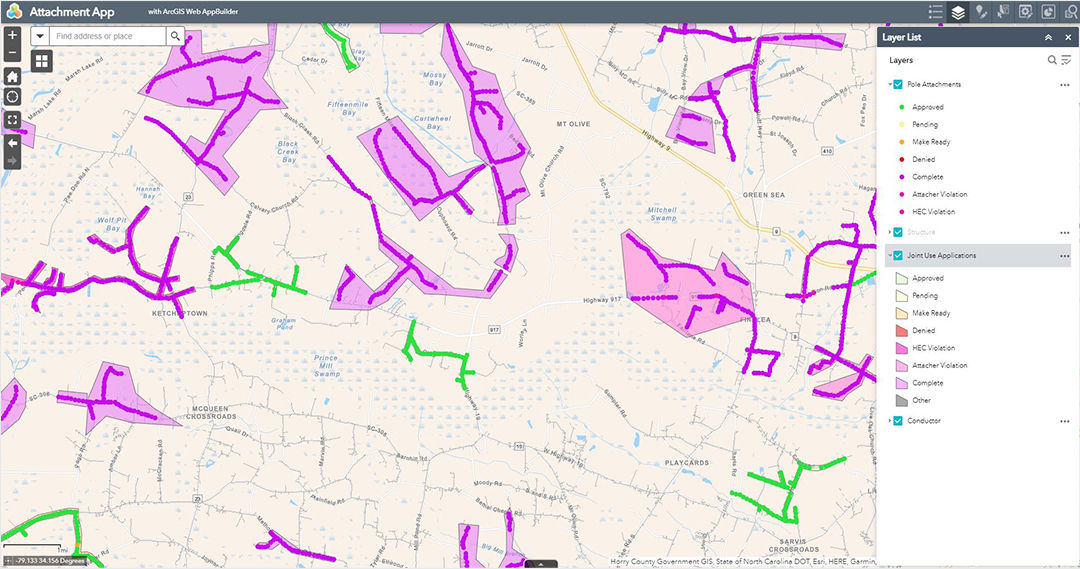

First, the utility moved its spreadsheet data into a geographic information system (GIS) to make it more useful. Staff then field verified this information with ArcGIS Collector to ensure its accuracy. After validating the existing data, HEC shifted its focus to improving the more extensive joint use process.
The local telephone cooperative submits many applications detailing its intended pole attachments. A GIS layer now represents each application and spatially relates it to the pole infrastructure. Each proposed attachment is marked and tracked through the application process until it is built.
HEC pole stakers use ArcGIS Field Maps to visit each location and determine the attachment suitability. Stakers may approve, deny, or note additional required work before attachment. Their determinations are immediately recorded and referenced by both HEC staff and that of the telephone cooperative.
The telephone cooperative's staff access the shared ArcGIS feature service. Therefore, they see application status and progress in near real time. For example, after approving a point, that attachment work may begin. Once complete, as-built information is also field checked and either accepted or noted for follow-up.

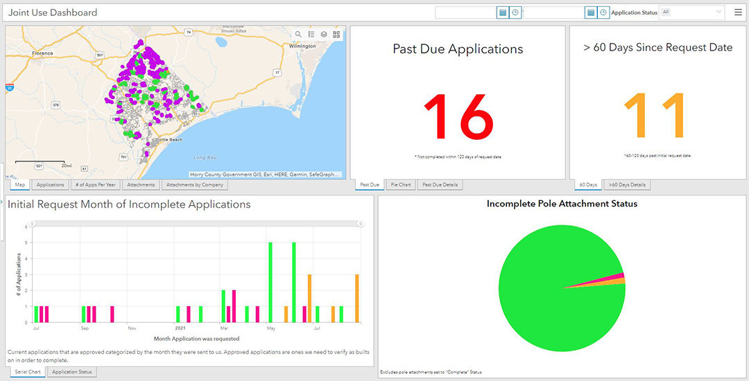

ArcGIS Dashboards is used to monitor the process and its timing and to report statistics. To ensure high levels of service, two key performance indicators (KPIs) draw specific attention to stale applications.
HEC uses dashboards to monitor progress, timing, and key performance indicators.
