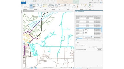

KU used Milsoft's WindMil software for engineering analysis and needed a new solution to integrate with it. So first, the utility upgraded to ArcGIS Enterprise and established a plan to transition from the geometric network to the ArcGIS Utility Network electric data model.
POWER developed the POWER Network Extractor tool to integrate third-party applications with ArcGIS Utility Network. For example, the POWER Network Extractor enabled KU to consume its GIS distribution, transmission, and subtransmission networks in the Milsoft WindMil engineering analysis package.
POWER implemented numerous data quality rules and configured the POWER Network Extractor to run every night. The extract for the WindMil application supports the utility's engineering analysis functions and also sustains the outage management system (dataVoice International).
