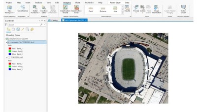

![Large imagery file of stadium is able to be processed within the portal](/en-us/lg/industry/transportation/stories/wisconsin-dot-improved-efficiency-moving-imagery-services-to-cloud-based-gis/_jcr_content/par/grid_container_copy/gc-par/columnsystem/wpar/image_1941736373_cop.coreimg.jpeg/1714684705168/stadium.jpeg)
And as Tony Van Der Wielen, GIS Infrastructure Architect at the agency, pointed out, “This is 2024; having that imagery and using portable hard drives to move it from agency to agency was pretty archaic.”

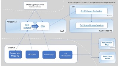

Using replicated content, over 100 hours of load-testing was performed on three architectural variations. First, the on-premises servers were tested, then content was moved to a hybrid of on-premises servers and AWS’s Simple Storage Service (S3). Finally, a combination of ArcGIS Image Dedicated and AWS S3 storage was tested. This revealed all the pros and cons before presentations were made to management and DET.
![This new plan brings a number of potential benefits including cost savings, specifications, and standards support.](/en-us/lg/industry/transportation/stories/wisconsin-dot-improved-efficiency-moving-imagery-services-to-cloud-based-gis/_jcr_content/par/grid_container_copy/gc-par/columnsystem/wpar/image_1939634547_cop_1344367763.coreimg.jpeg/1714684705367/imagery-data.jpeg)
“A lot of groundwork went into making sure that we were making the right decision to move to ArcGIS Image Dedicated,” said Van Der Wielen. “Our justifications were going to drive not just the project budget, but also budgets for AWS going forward.
The cost differences, however, were major. To store on-premises, the 100 terabytes of data mentioned above would cost the GIS team $260,000/year. To store that same volume of imagery in AWS and utilize ArcGIS Image Dedicated would be $20,000–$25,000/year. That substantial difference refers only to one set of savings—because users are accessing information from the same buckets, there is no duplication.

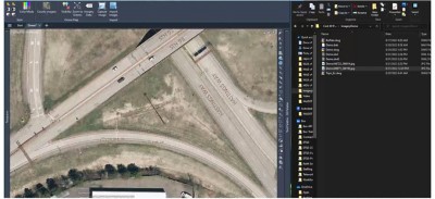

ArcGIS Image Dedicated and AWS now support streaming imagery services across all of WisDOT’s GIS platforms. This includes those for both public and private-sector use. Close cooperation with the Civil 3D deployment team has resulted in the ability to stream three-inch resolution imagery from WisDOT’s REST services and then extract smaller irregularly shaped project areas. For a project outline, all of this can take place in a matter of seconds, mosaicking everything into one image and then pulling it into the design software.
![Imagery of an intersection on a freeway is able to be dissected through ArcGIS Online](/en-us/lg/industry/transportation/stories/wisconsin-dot-improved-efficiency-moving-imagery-services-to-cloud-based-gis/_jcr_content/par/grid_container_copy/gc-par/columnsystem/wpar/image_225953384_copy.coreimg.jpeg/1714684705497/roadway.jpeg)
“Instead of just streaming in, they’re creating a mosaic image that stays with the design through all the stages of a project,” Van Der Wielen explained. “That gets archived so that 10 years down the road, people will be accessing the same imagery, but can then stream in new information. The downloads are smaller, as users are no longer having to pull down a whole GeoTIFF. It’s a unique way of doing things.”
