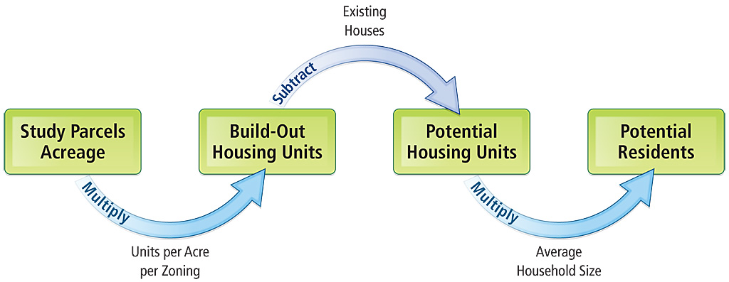

After calculating the acreage of the study parcels for each zoning category and sewer basin, the acreage was reduced by 15 percent to represent the amount of land typically required for infrastructure such as roads. Next, the units per acre were determined for each zoning category. Build-out housing units were calculated by multiplying units per acre for that zoning category by the acreage in each zoning category. To make the results more accurate, the number of structure address points in study parcels was calculated for each zoning category and sewer basin using the Spatial Selection tool and subtracted from the build-out housing units to generate the number of potential housing units. Finally, multiplying the average household size, based on the most recent U.S. Census data, yielded the number of potential residents.
