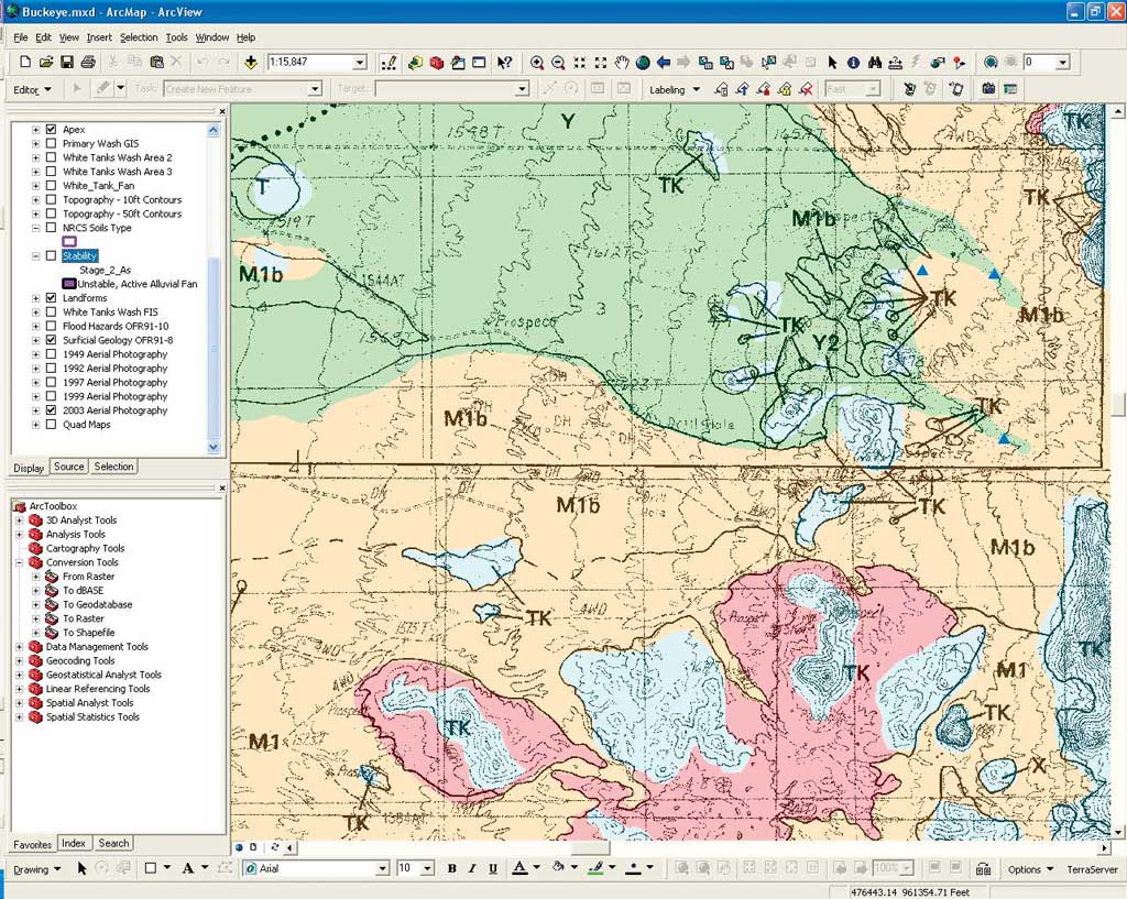

| Stability mapping (the colored areas) overlaid with the Flood Hazard Map. |
Typically, GIS mapping of feature perimeters performed on-screen in the office was quite accurate, often to within two meters. In a few areas, the terrain exhibited sudden, severe changes in elevation that were not visible in the air photos. In these areas, the mapped edge of a fan had to be adjusted in the field by as much as several hundred meters.
